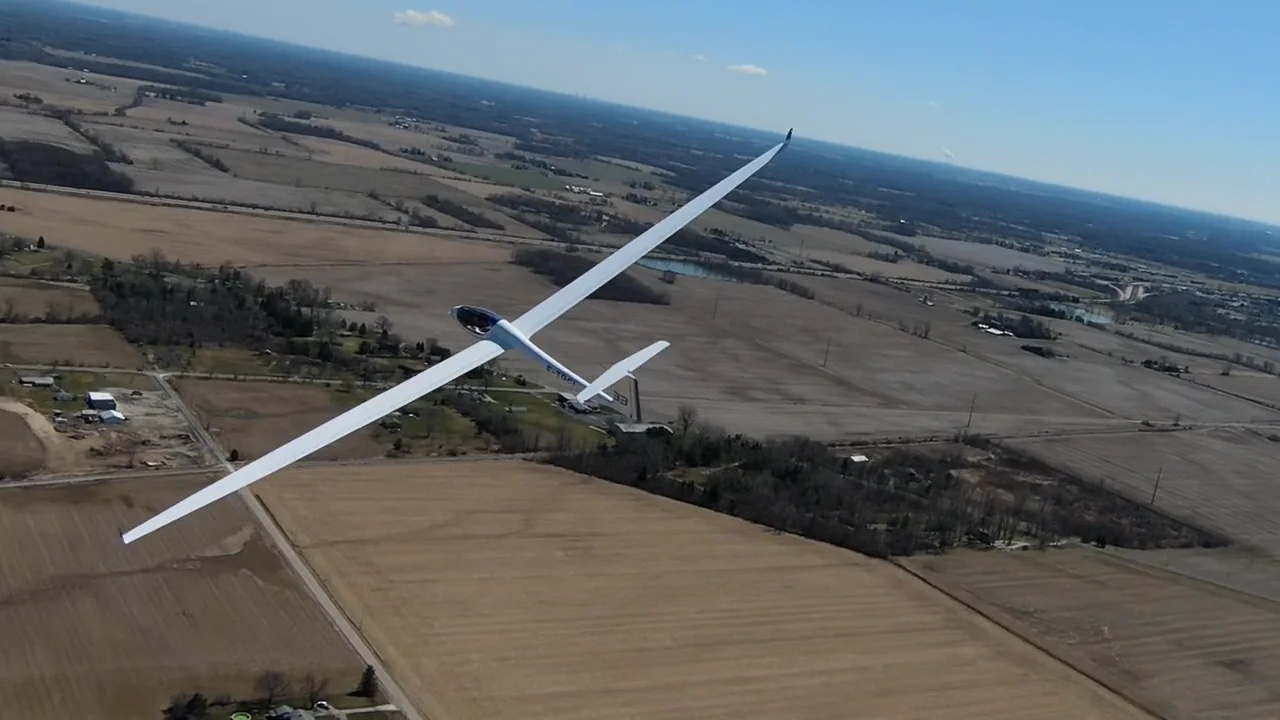

Built this summer an AS33 half scale from Rosenthal USA, a sexy 9m wing for sure
Comes as a kit with prefinished wings, foam carbon obeshi already lived hinged and a bare fuselage with canopy, canopy frame and molded rudder. A decent amount of work, but a very satisfying result. I have covered the wings with vinyl, and all servos have been mounted with IDS linkages, very slick. Wings airfoils have a thin airfoil designed by Philipp Kolb for GPS racing, should be a winner!
Power is a Torcman NT530-45 that turn a 20x13 on 12S 5000S, about 2:30 of motor time that gives you a solid two climbs

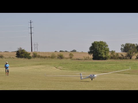

Here is a video of the first two flights, first on tow and second ROG. Very of the flying characteristics, easy to fly, its is like flying on rails (glider weigh only 23Kg, 50lb)
