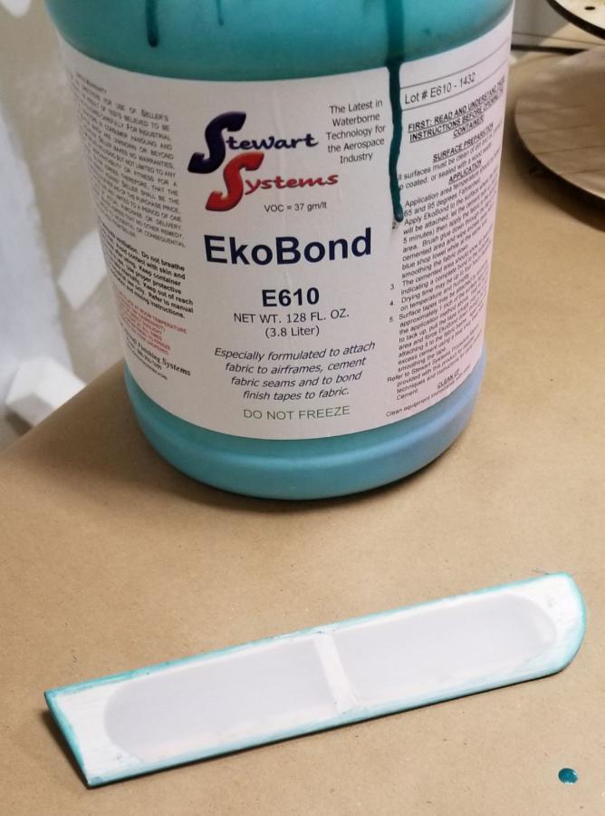

    I covered the trim tab on the Bocian first. Nice little surface with enough challenges for how things wrapped around. I also have a flat piece of ply with a square hole in it to see how things work around spoiler cutouts and servo openings. So far, the results seem good for just doing the covering.

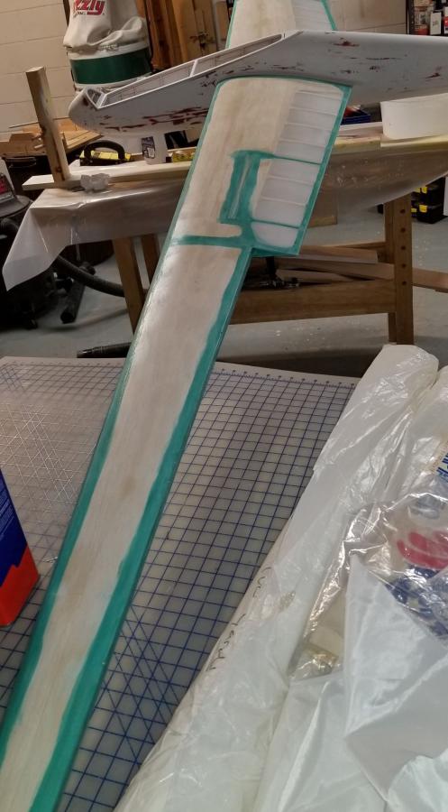

    Using it for applying the fabric is a little bit different. You apply the EkoBond around the edge where you want to attach the fabric. Then you let it dry. It is tacky enough when dry that you can press the fabric into the film of EkoBond applied to the edge. A little ironing around 200F sticks it a little better. The odd in the covering steps is that after you trim the edge and stick it down, you have one more step. Brush some more EkoBond over that edge and then wipe it off almost immediately so that only the EkoBond that penetrated the fabric remains. If you put too much on and leave it dry it remains rubbery and that junk is going to show in the finish.
    On the second side, you want to apply EkoBond on the edge and up tyo wherever you want your overlap to finish up. The nice part is you can work the fabric in place around the edges and round pieces and then mark where your trim line will be. Then you can pull off the edge so you can do the trimming. After that stick it back down, and iron the edge. Finally, brush on and wipe off over the edge with some more EkoBond.

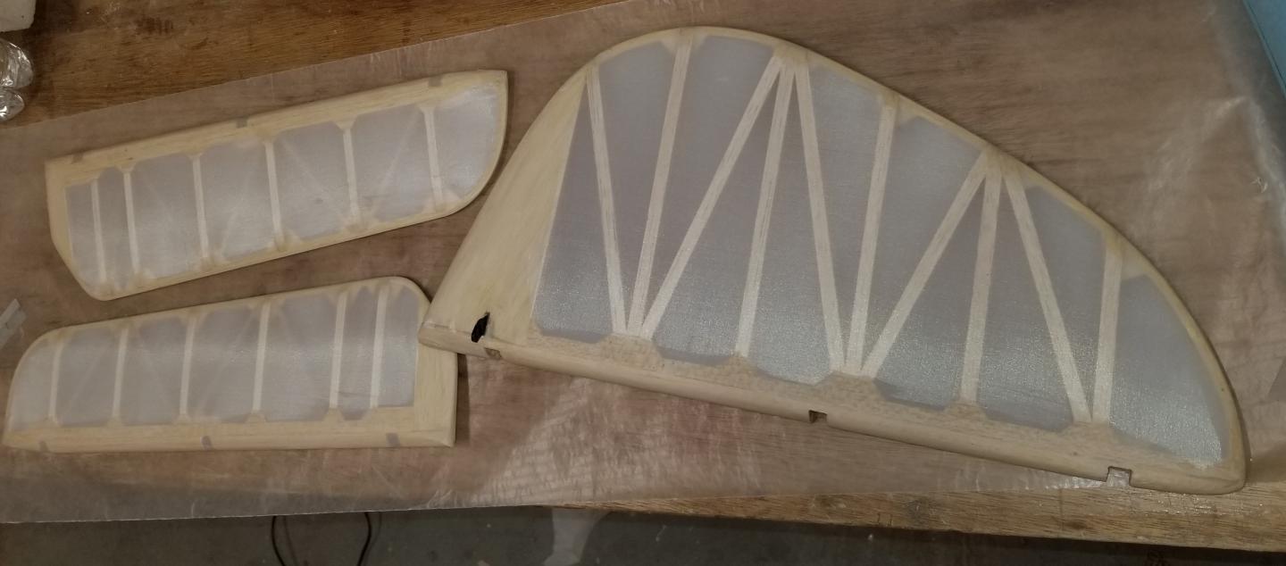

    I now have a couple of clear coats on the fabric to seal it. The fabric edges present some new challenges. Of course, they are always interesting getting sealed and flat and filled. the EkoBond is flexible so it really doesn't sand. So drips and fuzzy bits of fabric edge require some consideration. I had some edges where the fabric was a little rough or a thread or two was loose from the edge. After sanding a bit of the surface, where yoiu start getting some fuzz from the fabric, I put down some thin CA and wiped that onto the surface to harden it and make it smooth. It seems to be working fine to smooth the edges and overlaps a little before going to primer.

          So far things are progressing on the project. I put three coats of polycrylic on to seal the surface. It was warm Monday and I had a chance to spray some more primer. The elevators look good. I had some problems with the rudder structure. The outline pieces from the kit are plywood and these had the bow that you sometimes get in sheets of 3-ply. Because of this, the rudder was a little warped near the bottom. I stripped the fabric off the rudder. I didn't have that much of a problem stripping it from the rudder Now after some carbon strips, the rudder is straighter and it has been recovered.

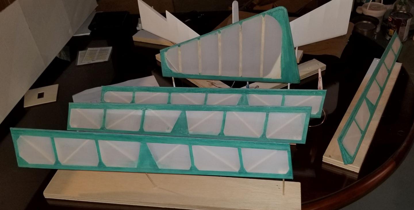

          I covered the wing ailerons. I have them split so there are four ailerons. It is kind of wierd working with glue that you paint on first but it is not sticky when it is dry. Brushing and wiping some of the Ekobond on the fabric before final cutting is handy. It just adds enough to keep the fabric together so you get a minimum of stray threads from the trimming. The edge seam is nicely cut and wraps around the edge. Things are sticky enough that you can wrap around the end of the control surface, Then use a pencil to mark the exact surface outline, pull it back and trim perfectly.

                Be patient waiting for the stuff applied to the frame to dry. The pieces I left dry overnight were the easiest to get the covering on nicely.
                Make sure you avoid having some runs or heavy spots on the frame. before applying the covering. It just makes for using more primer to get things smooth.

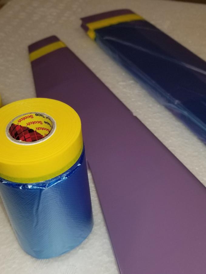

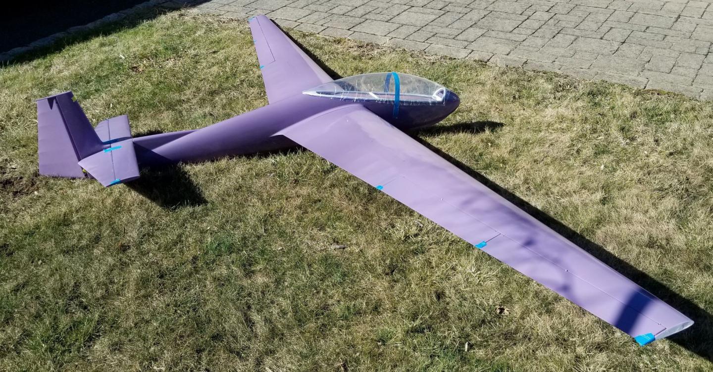

                I can't believe the warm weather in early March. I managed to paint the entire airframe of the Bocian in RAL4005 already. Now for some time doing the masking to paint the bits of red on the modfell.
                  Out in the sun.
                    Masking things for the red paint on the tips. I found some nice stuff from 3M. It is masking tape with folded up plastic already attached. The roll there actually has about an 18 inch wide piece of plastic and it clings really well to the paint being covered. Definitely worth the $9 a roll on amazon.

                        Thanks for the info. Mine was about $9 for 20 meter roll, 2ft wide. It was someone using the Amazon platform, not actually from Amazon.
