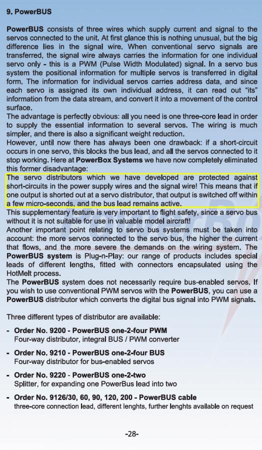

                          This is a question for SteveP.
                          I've been reading up on PowerBox systems and came across this in the manual for the Champion SRS.
                          In the highlighted section, does this mean that if your gear servo jams/shorts out the PB will automatically cut it's power?

                            Hi. You’ve asked multiple questions. It’s important to remember a jam and a short are not necessarily the same thing. It is very possible to have a servo impropriety center and create a current drain over a period of time that kills a system — or partially jam and drain more quickly still without shorting per se. Of course a severe jam will drain, quickly overheat the servo, melt the wire and servo and only then potentially cause a “short” as the wire melds together or servo goes to $#!+.
                            Of course, shorts can happen anytime from wiire wear, getting caught in a mechanism, etc.
                            There are two outputs on the left side of a Champion to drive the PowerBus wiring system. Similar to what Rtjw points out above. PowerBus does what you have highlighted.
                            The PowerBus line is here... https://www.powerbox-systems.com/en/...cessories.html Click on one of the PowerBus products and you will see a full explanation of the system.
                            Hope this helps.
                              I can attest to the PowerBox (PowerBus hub) isolation functionality from first-hand experience. During the shakedown flights for my then-new (and now departed) JS-1, a screw backed out of the landing gear hub/frame. It was eventually enough to prevent the gear from fully retracting, because the screw would jam hard against the bottom edge of the open gear door. On the 20-30 minute flight where it eventually jammed up, the lighting and contrast conditions made it hard to see the gear was still partially extended, so I didn't notice until setting up to land. The gear extended just fine and I never had any battery drain problems or low voltage alerts, and nothing was toasted or even warm.

                                That would be great if the PowerBox unit itself has the cut out. I'm still not sure if I need to use the PowerBus feature just yet. But if it offers circuit isolation due to current overload then it would be worth it just to put the gear on at least.
                              • BryanB
                                BryanB commented
                                Did some browsing on the PowerBox forum, phew not easy, but anyway I saw your post and another similar and it sounds like no circuit isolation for the PowerBox unit itself. The PowerBus units have auto-reset fuses that activate at around 7amps. At least that's what I understand from what Richard German had to say.
