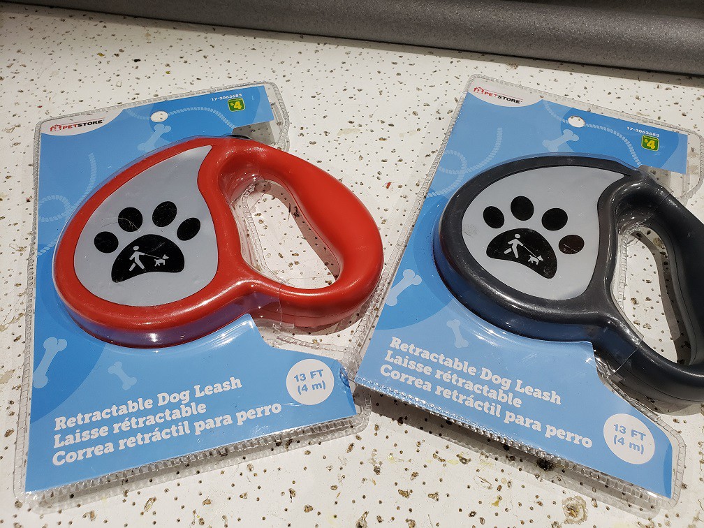

    I bought these at my local dollar store, but I think you can get them on Amazon as well.

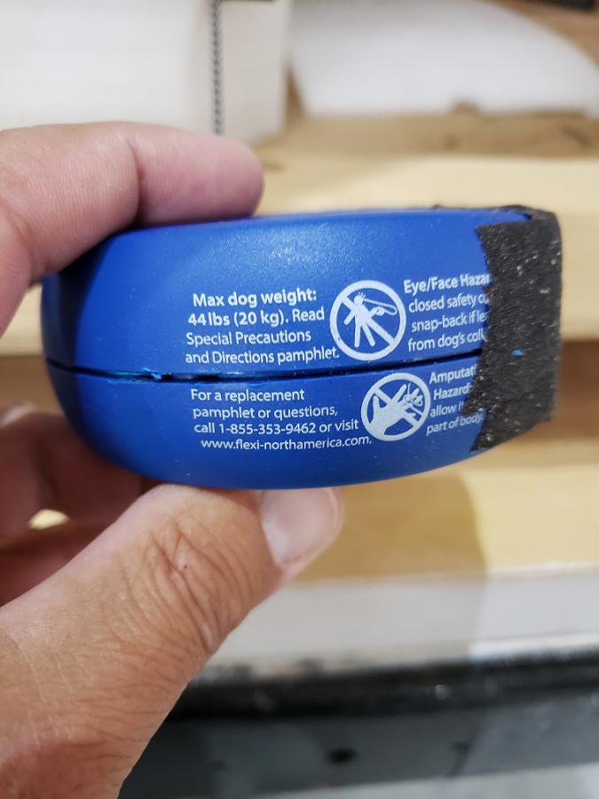

    The ones I got were for 44lbs/20kgs dogs.

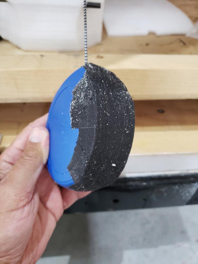

    I cut off just about everything that wasn't useful for my installation, and then covered over the opening with hockey tape.

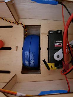

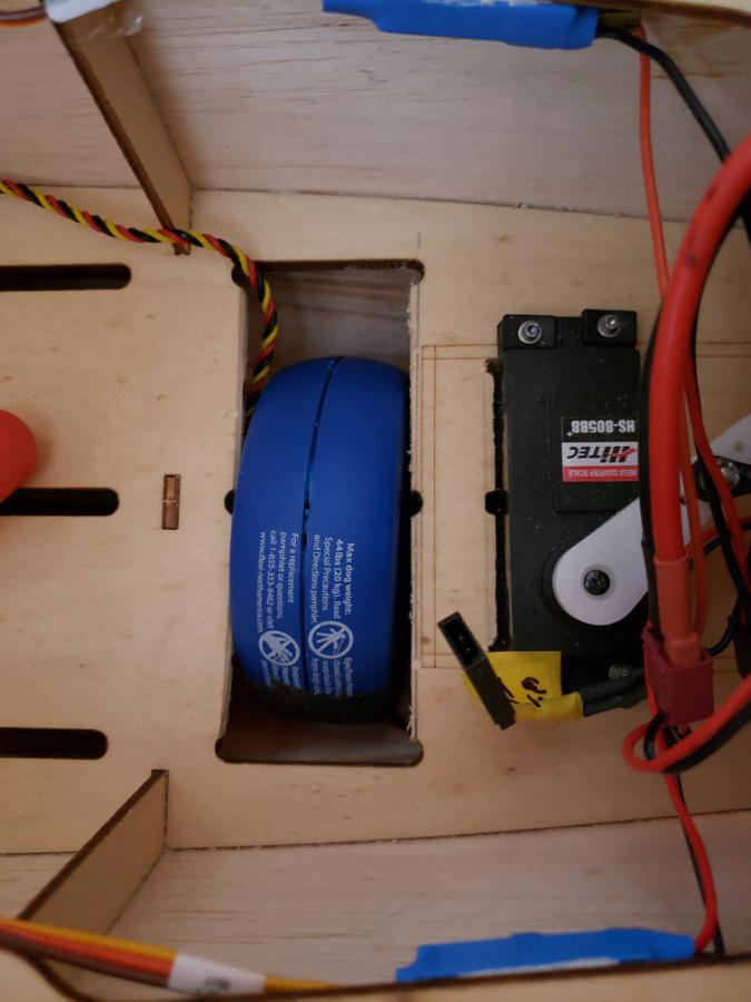

    I then located it in the forward fuselage just aft of the release servo. I originally wanted to install it fore/aft but couldn't in this case so a sideways installation it was!

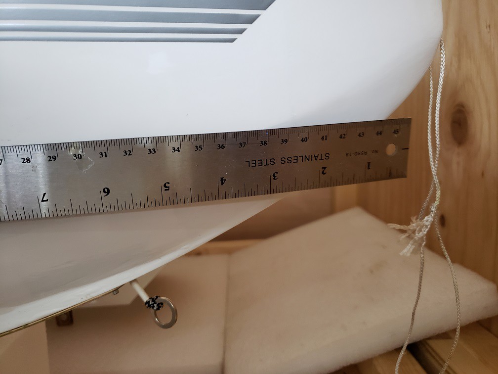

    For the actual routing of the braided line I used a 12" drill bit and drilled from the inside of the airplane down on a 30 degree angle. My airplane has a nice thick skid so it worked out perfectly as an exit point for the leash. I used some of the hardware that came with the leash to make a small grab thingy, then finished it off with some heat shrink.

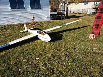

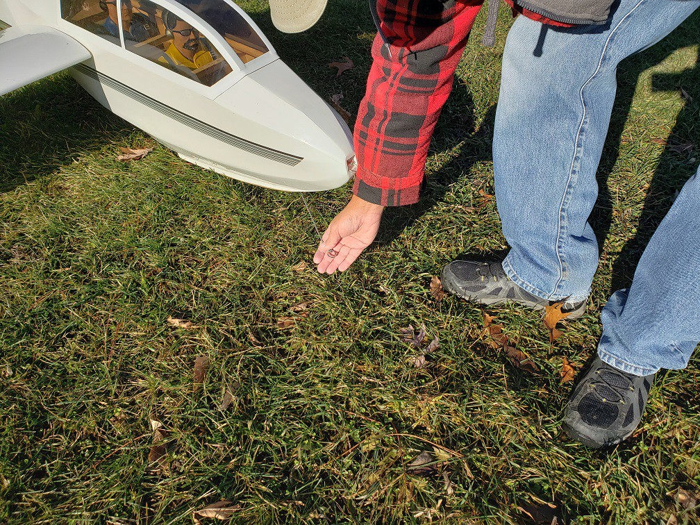

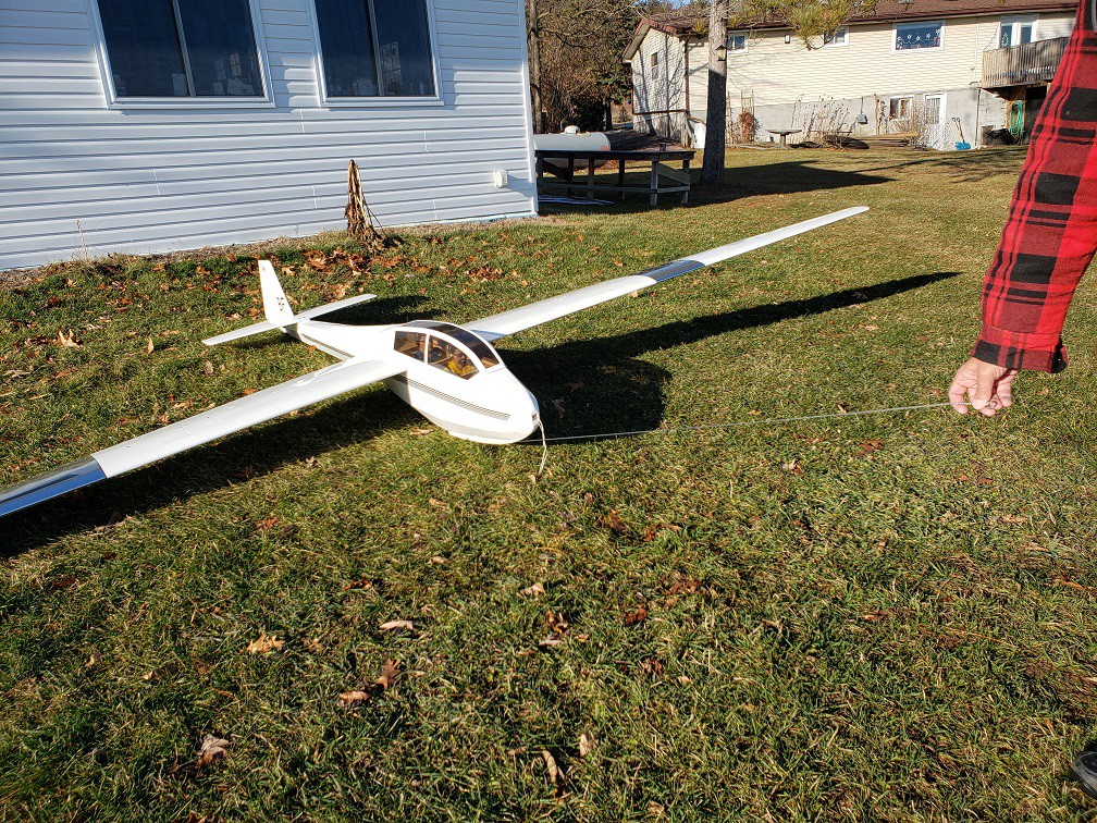

    I just reach down and grab the little ring and start walking off the active, easy peasy!

    The leashes that I buy have about 4 metres of line on them so I just cut them down to about 1.5 metres which seems about right.
