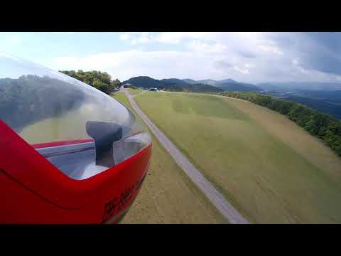

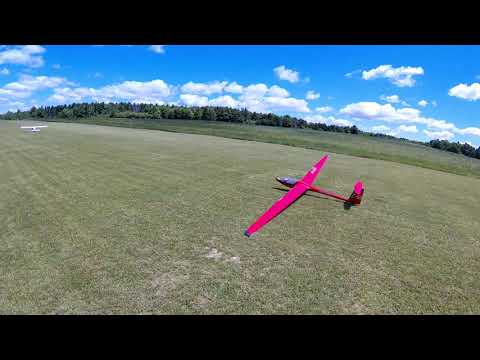

      After some technically difficulties and then going back to work, we were finally able to get out and maiden the DG 800! First flight went well, made some adjustments and then it really came to life! Working on getting it dialed in and having a blast with this thing! Last flight of the day we we towed right into a thermal and I was able to speck it out and had to do some aerobatics to get it back down. 15 minute flight! Thanks to Len B and Scot S for all their help and guidance wit this plane, so happy to finally have one! Check out the video at the bottom as well!
      • Mosquito
        Mosquito commented
        Beautiful airstrip
      Very nice!!! Love the ZooM Zulu Mike...
      look out everyone, a new Ferrari is in the sky's now.
      Congrats on your maiden...
        with the ix20 tx now you need a power safe telem rx to give you vario and speed reports then you will know for sure how great this plane is and i like to monitor the rx packs on the telem as well. glad the flights went well. now get the skylark up and going...
          awesome, congrats Kevin! Yeah...love the ZooM on the tail....
            Congrats Kevin,. The menstrual looks good. I hope you get to fly it more than once a month..
            Plane looks a bit nose heavy, it should hold the flair without the extra porpoise.
            Excellent!!!
              Another video of the 800 in action at Cumberland.
              • Csessa
                Csessa commented
                Sure, show the smooth landing!!! Nice video.
