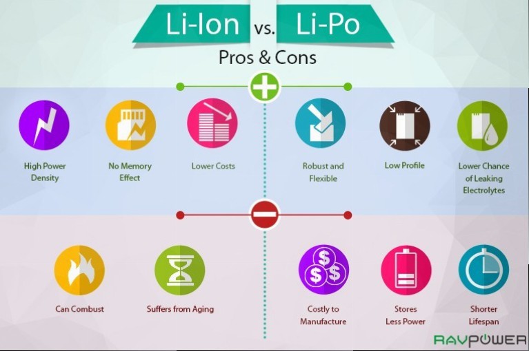

    While both can combust, LiIon pack more power. I have both in various planes and each serve their purpose.
    If you are going with dual 5000’s, I wholeheartedly recommend the PowerBox PowerPak 5.0 x 2 packs. Nest of all they charge on any 12v source, even a car cigarette lighter with no special charger needed. No muss. No fuss.
    PB also has an affordable replacement program when they get old. https://www.powerbox-systems.com/pro...ku-system.html.
    Click image for larger version  Name:	 Views:	1 Size:	63.7 KB ID:	36943...............
    • ARUP
      ARUP commented
      Great visual, Steve!
