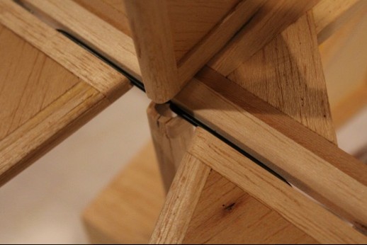

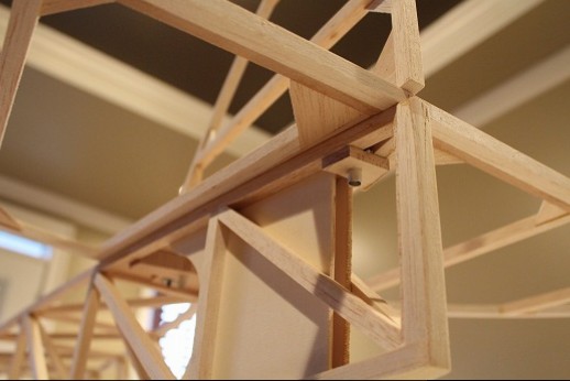

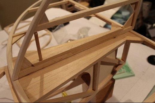

    Dobranoc! I put the elevator horn in position so you can see the clearance needed at the fin post. The fin and rudder are done. The stab was aligned then pinned onto the fuselage then the mounting holes were drilled. 6-32 bolts and 'T' nuts will keep the stab in place. The 'T' nuts were secured with 30' epoxy at their surface and onto the stab mount plate. The bolt heads are proud of the surface so the fin's bottom edge was clearanced for these. Next, pilot holes were drilled into the stab and through the fuselage. The holes were enlarged in the stab and fuselage to fit aluminum guide tubes for wood dowels located in the fin. What was done was to dry fit the tubes and pin the fin to the stab then push a sharpened dowel segment up through the tubes and into the fin's base. This provided a 'punch mark' guide for drilling the fin to receive the dowels. Then all was taken apart, glued then re-positioned for the glue to dry. What is neat about this set-up is the aluminum tubes are proud of the stab mount surface so the stab can be placed in proper position easily then its bolts screwed in place without fiddling around for alignment. The wood dowels glued in the fin are long enough so the fin LE won't 'rise up' at speed. Cables and turnbuckles will secure the tail feathers relative to each other. Split pins will allow easy disconnect for dis-assembly as is done for the Vampyr and Eaglet.
