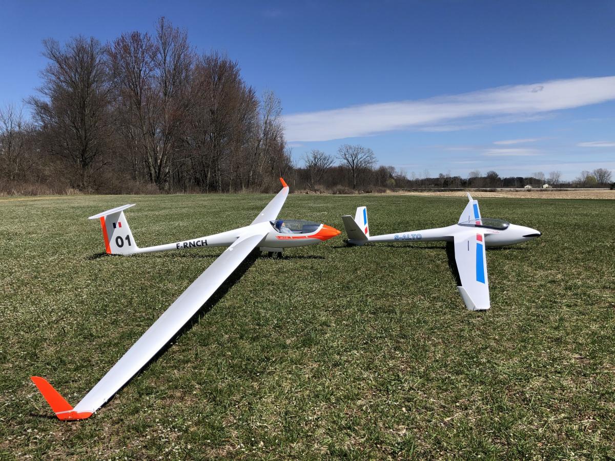

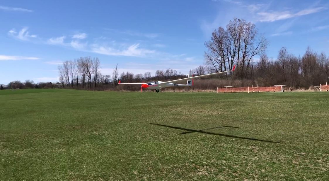

      Did the maiden on mine yesterday, went like a charm. A great afternoon here in Michigan with low wing and heat to catch scarce thermals
      The take of without bungee is a delight, I will post later the maiden of my Salto (bungee lauched)
      That will be the perfect tool for the lonely towplilot!
      CG75mm and need to go back a bit

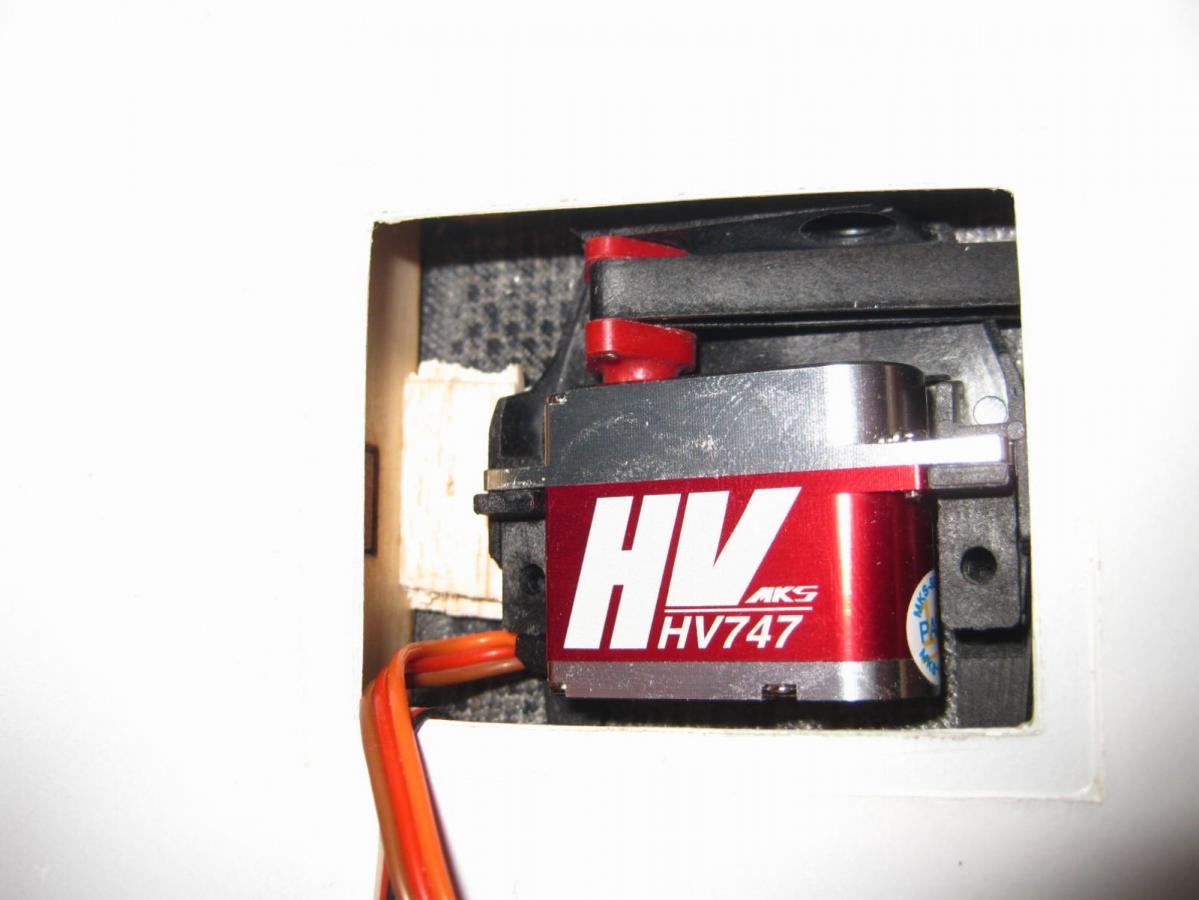

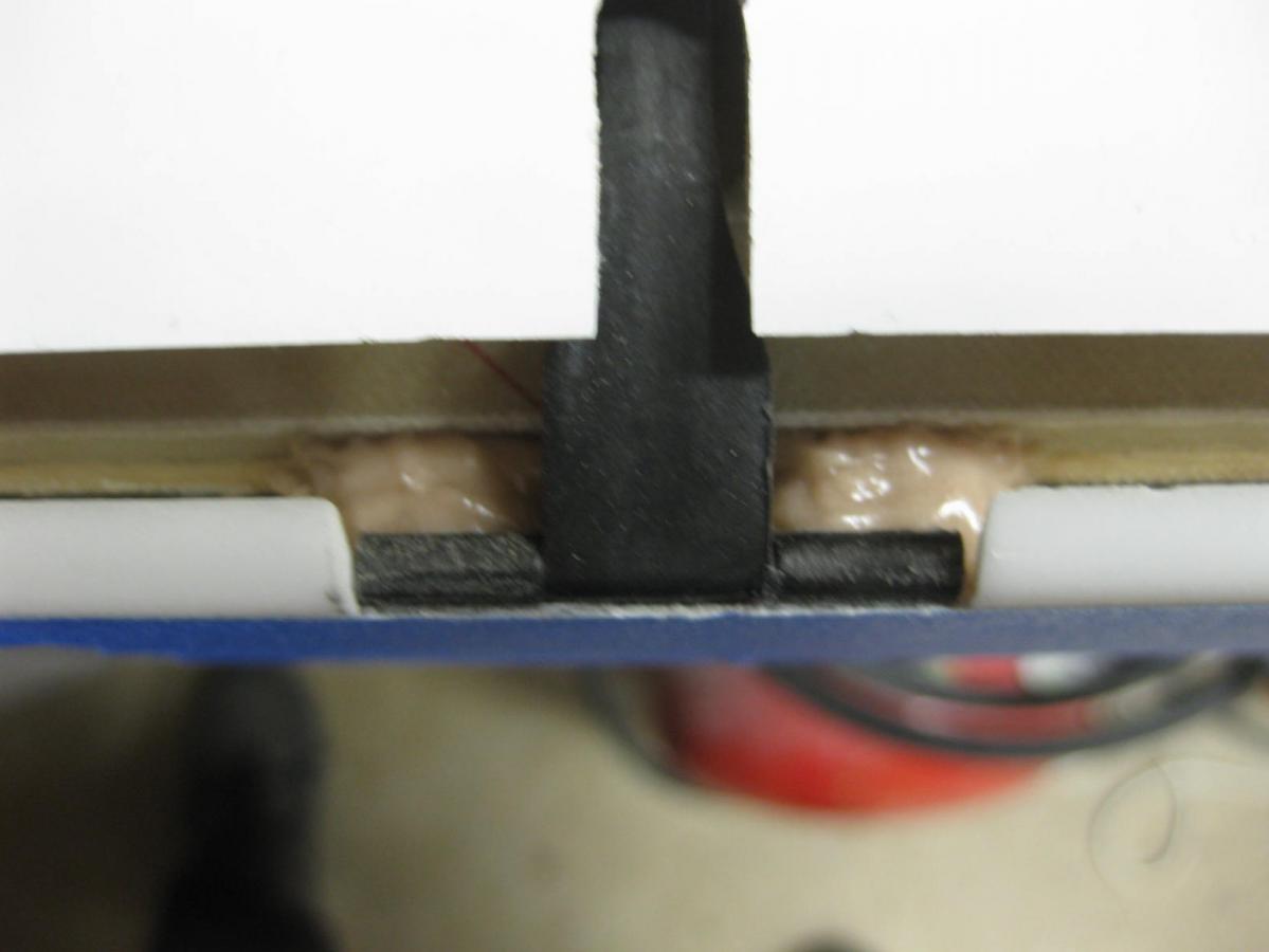

          Finally getting around to my ASH-31, since I'm going to be using it for GPS triangle racing I'm installing the IDS system from Soaring USA for the MKS HV6130 servos
          https://www.soaringusa.com/Servo-Fra...6130-Pair.html
          Of course this requires some drilling/grinding/filing - and the prerequisite courage to do it..... At least there a nice "How To" video for the installation process.
          Click image for larger version  Name:	6130 IDS#1.800.jpg Views:	1 Size:	38.8 KB ID:	36331Click image for larger version  Name:	IMG_4967.JPG Views:	1 Size:	87.8 KB ID:	36332Click image for larger version  Name:	IMG_4969.JPG Views:	1 Size:	54.1 KB ID:	36330 Click image for larger version

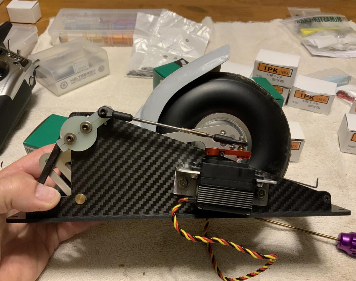

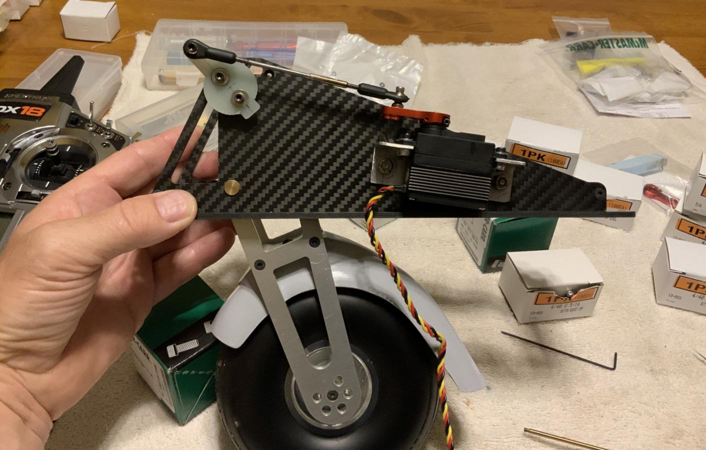

              After my gear started acting up in my ASH31 I decided to do the servo modification inspired by the one Stéphane posted. I used a heavy duty servo so I didn't use the music wire strain relief spring. I also angled the servo a little so the pushrod is as parallel as possible to the servo arm. I figured 403oz-in could handle the occasional duty cycle without too much trouble. Plus it's HV so I can bypass the voltage regulator as well.
              Works like a champ! Thank you Stéphane and Len for your assistance.
              Click image for larger version  Name:	ASH31_GearMod_01.jpg Views:	2 Size:	125.7 KB ID:	36392
              Click image for larger version  Name:	ASH31_GearMod_02.jpg Views:	1 Size:	152.6 KB ID:	36393
              • #82
                Right on! That's the way to do it..
                • #83
                  Bryan,
                  Great work! What servo arm did you use? Looks like a nice metal one and they are hard to source it seems for ones that have enough area to drill and tap.
                  • #84
                    Stew, you're not kidding. Metal 24T Hitec arms are few to choose. This one is a Apex RC Products 24T Hitec Red Aluminum Dual Clamping Servo Horn. They come with two holes drilled and tapped for 3mm but I ran my 4-40 tap through with minimal removal of material and I sacrificed one to see how much torque I could put on it. I think it'll be sufficient as I put on a pretty good bit before starting to strip the aluminum threads. I found a couple other arms but they aren't as substantial and would require lock nuts. I should probably have just used 3mm hardware all around but.......
                    I originally used the stock composite Hitec arm with lock nut but after drilling it for 4-40 the hole was almost touching the two other closest pre-drilled holes and figured it would oval out after a bit of usage.

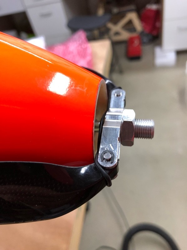

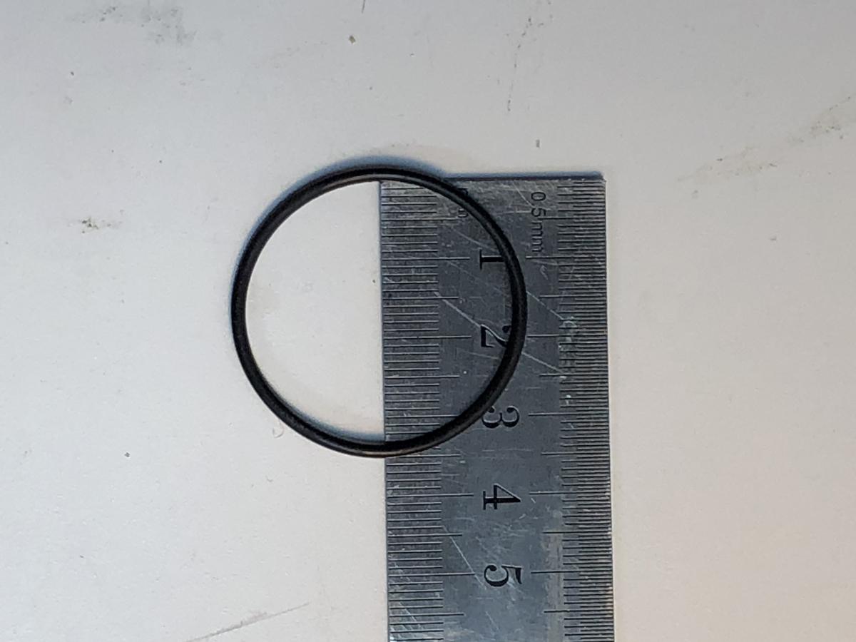

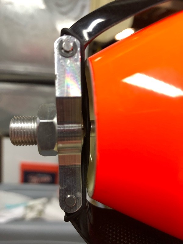

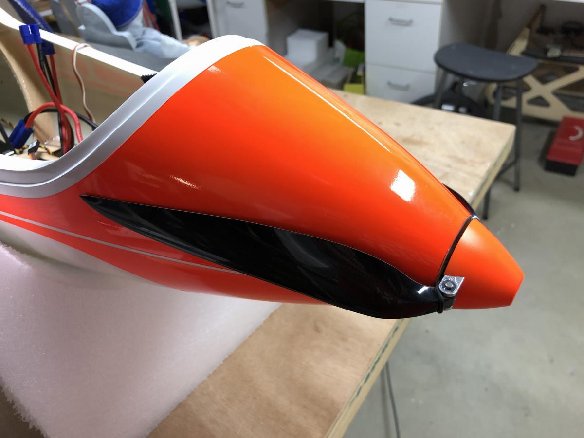

                          Here is a small tun up for the prop to avoid damaging it when you pull back the sailplane by the tail.
                          I used a O ring #57 or 35mm diameter and twisted it twice on the prop (on twist on each side of the shaft. Works great! no more damage on the ground or in the car...
                          Just need to sand a bit more the fuse to have enought clearance for the O ring
                            Great Idea!

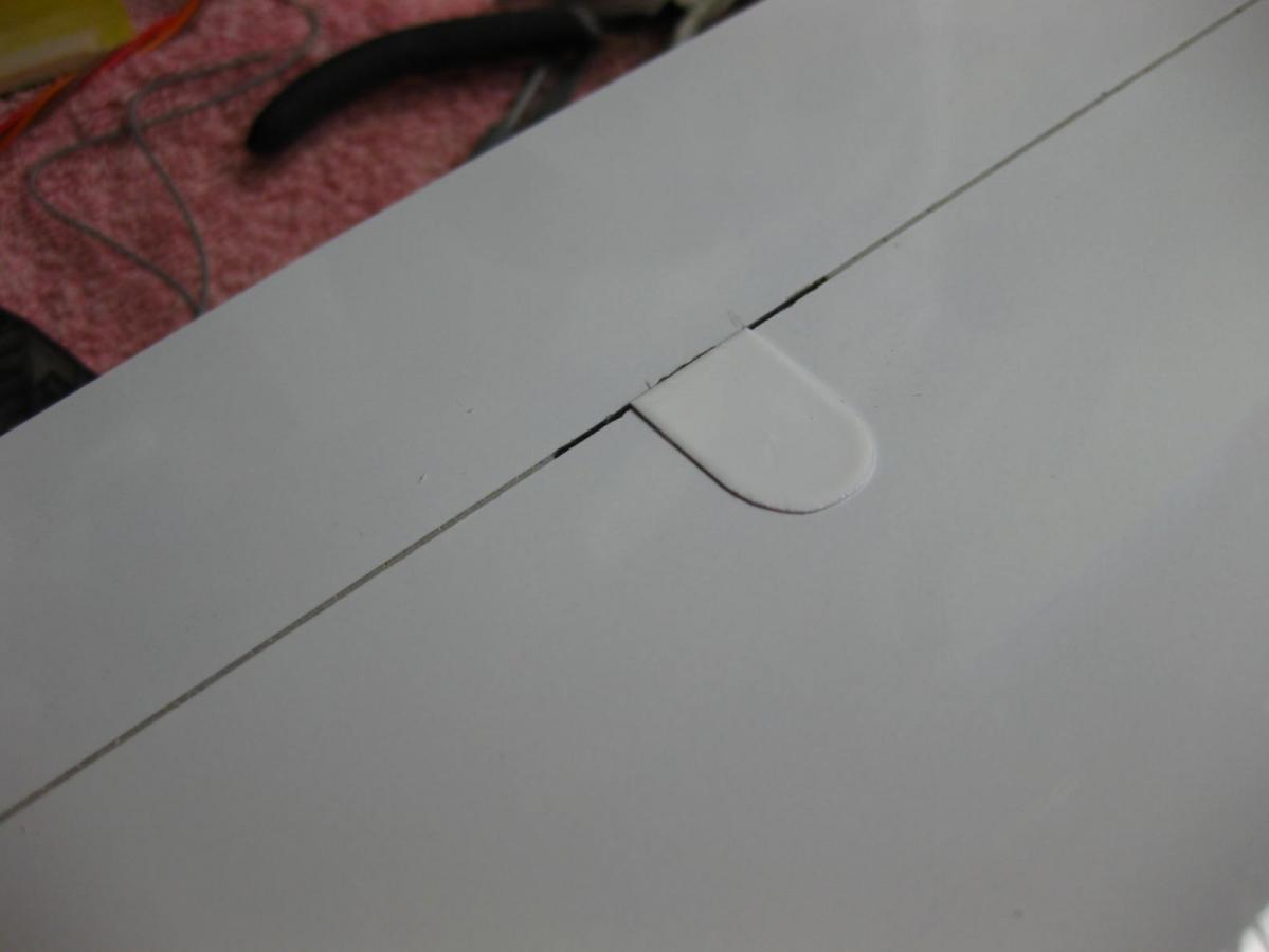

                          IDS install on the Flaps -
                          Click image for larger version  Name:	IMG_5017.JPG Views:	1 Size:	52.2 KB ID:	36519Click image for larger version  Name:	IMG_5018.JPG Views:	1 Size:	100.8 KB ID:	36520
                          Click image for larger version  Name:	IMG_4985.JPG Views:	1 Size:	49.8 KB ID:	36516Click image for larger version  Name:	IMG_5002.JPG Views:	1 Size:	72.1 KB ID:	36521
                          Click image for larger version  Name:	IMG_5015.JPG Views:	1 Size:	38.2 KB ID:	36517

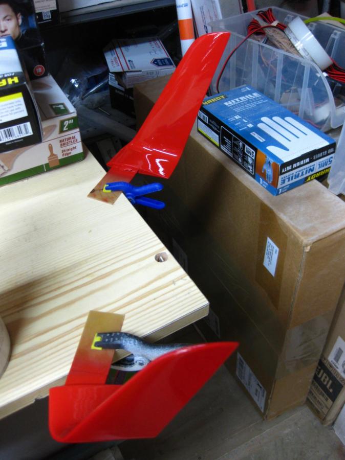

                          In preparation for the Thunderbird color scheme - AeroThane #187 Christen Eagle Red
                          Click image for larger version  Name:	IMG_4978.JPG Views:	1 Size:	72.5 KB ID:	36518

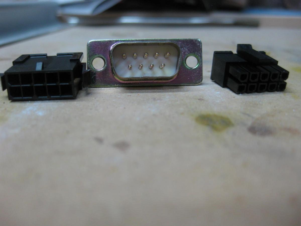

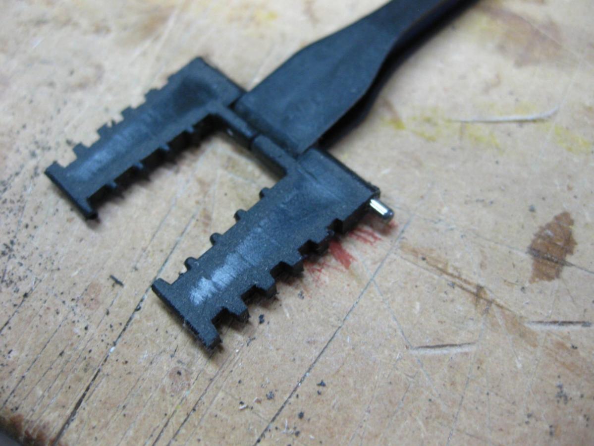

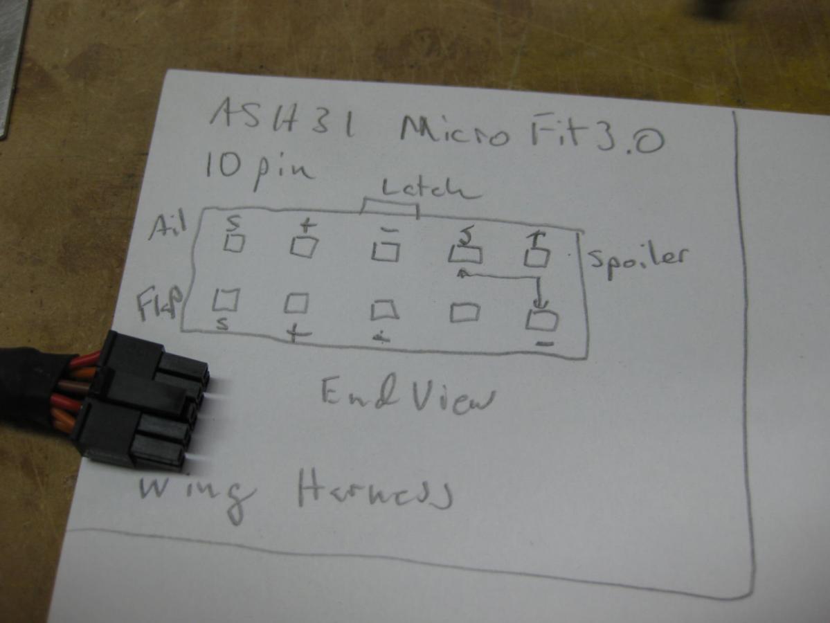

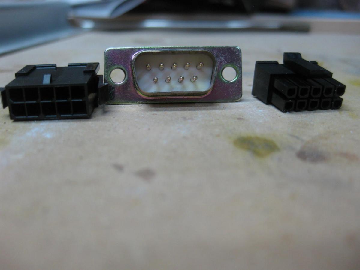

                          Molex MicroFit 3.0 - dual row - 10 pin locking connector for the wing wire harness.
                          Click image for larger version  Name:	IMG_4982.JPG Views:	1 Size:	56.9 KB ID:	36522Click image for larger version  Name:	IMG_4965.JPG Views:	2 Size:	60.2 KB ID:	36524

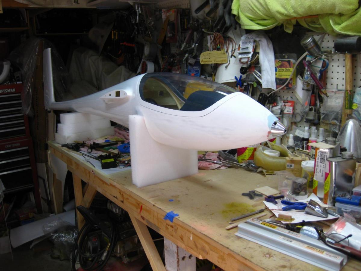

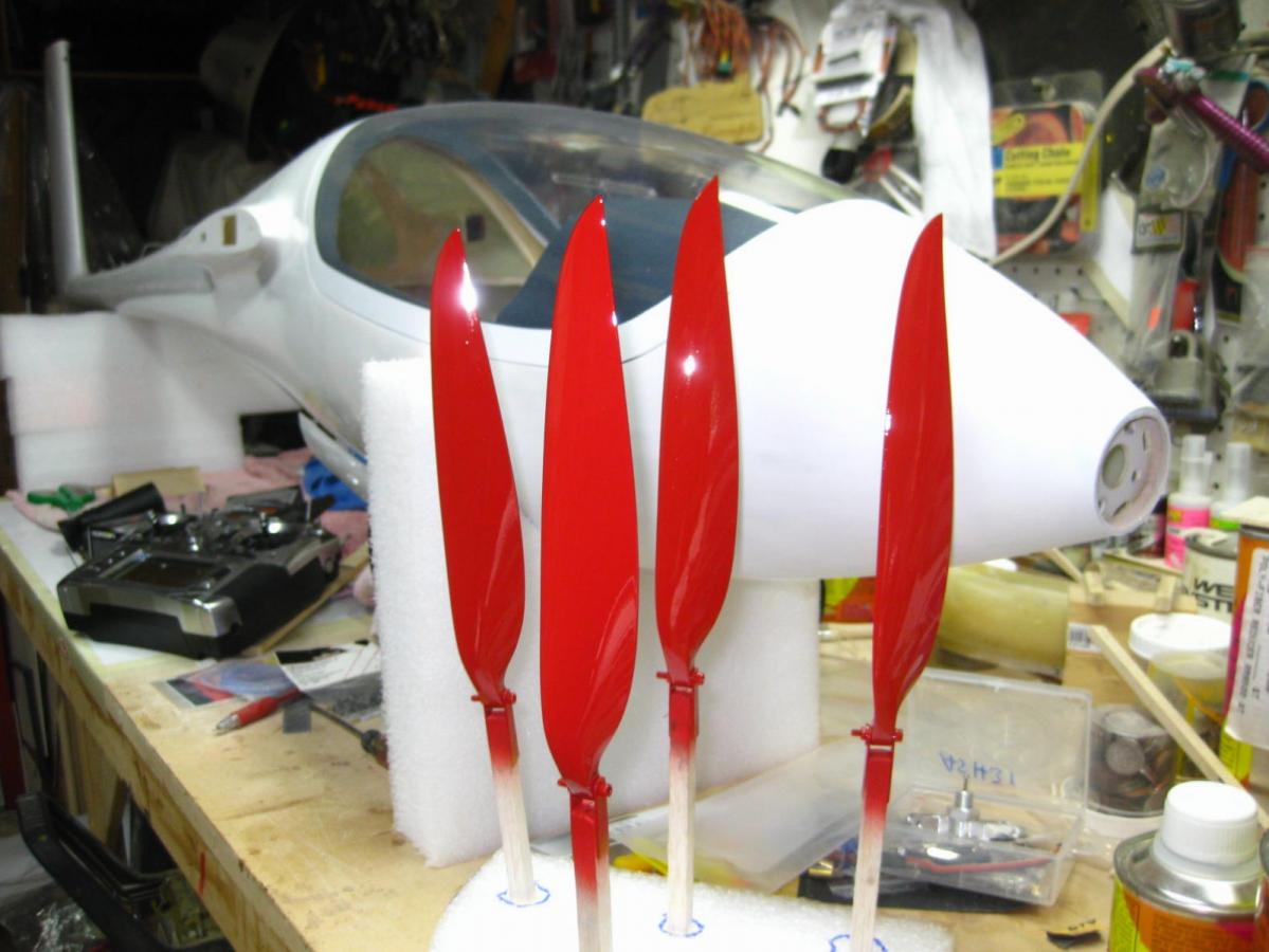

                        • #90

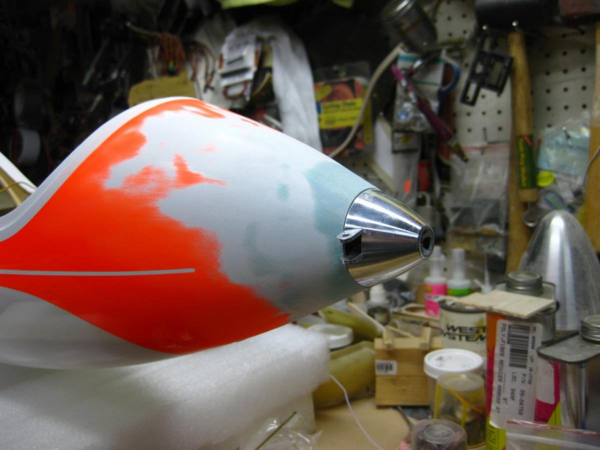

                          Front end work,.... as I was matching the spinner I decided to even things up a bit with finishing putty......and sand off all the anti-collision Orange....

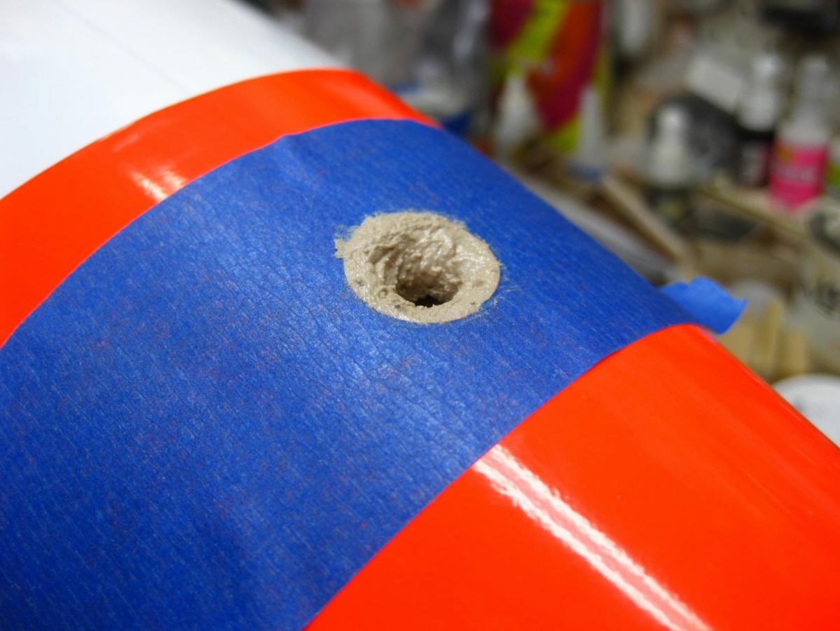

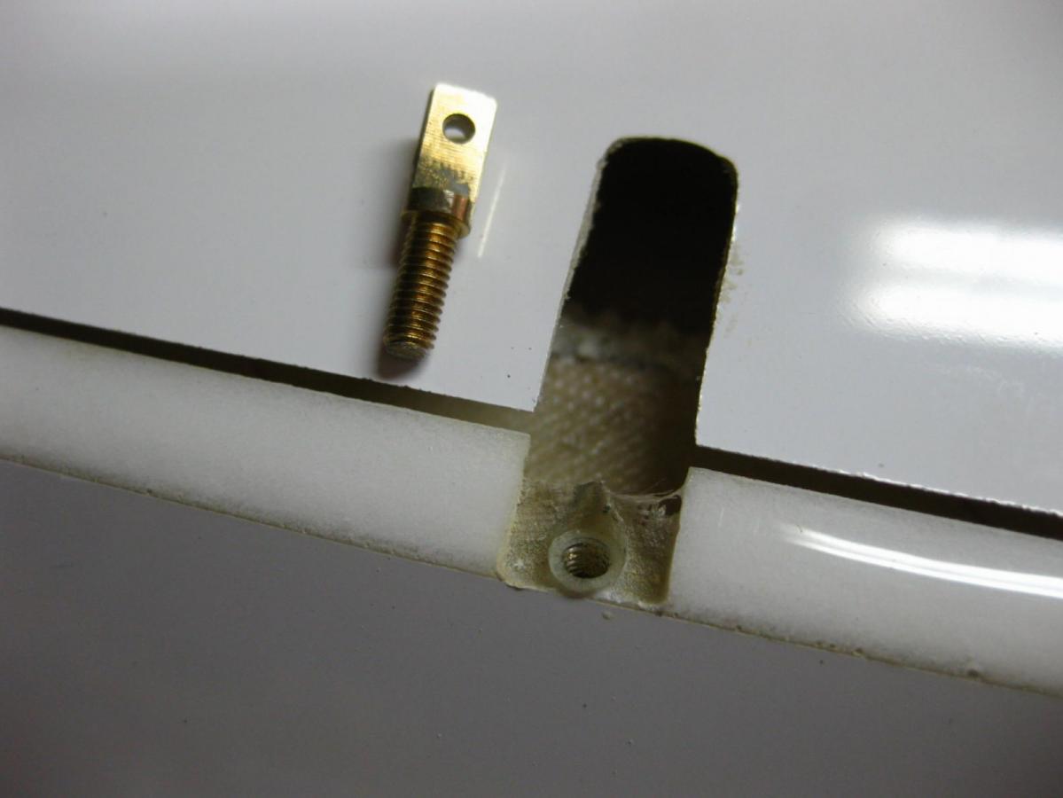

                          Filling the tow release hole with west systems / #410 micro lite filler.

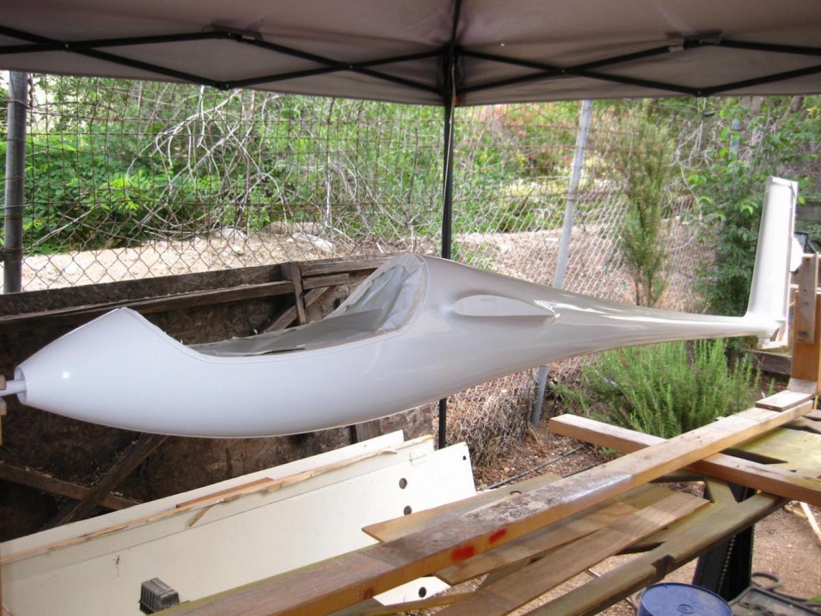

                          At least the motor mount makes it easy to rotisserie the fuselage for painting.
