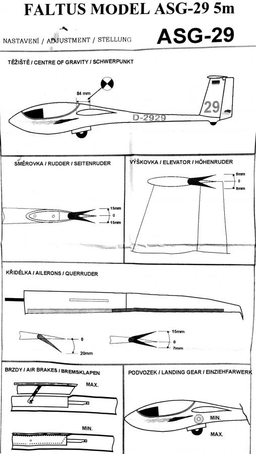

I have read up on the CG for this plane... listed at 84-85mm however I did see someone state that it's very nose heavy in that range. Someone mentioned flying at 98-100mm with still a slight pull out in dive tests?
