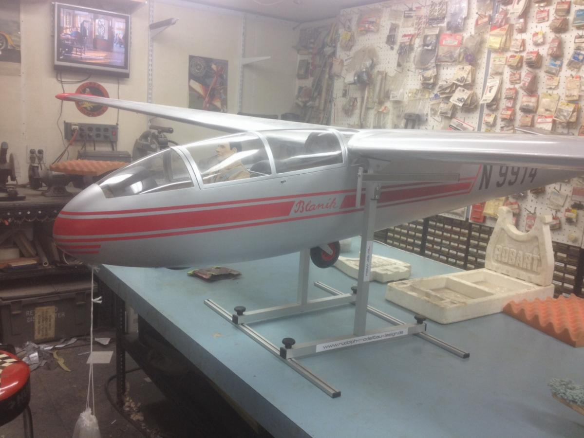

    Believe it or not, my Eflite Blanik is just about ready to fly. The CG listed in the manual is 15mm - 20mm back from the LE. However, several have recommended 30 - 40mm. Suggestions would be appreciated....thanks, Bob Brown

ID:	29563 HI had started at 40mm back and a dozen trim flights later I'm as far back as 50mm
      I had some removable led plates.
        I balanced mine at ~50mm. I wouldn't go any further back than it is. Takes full rudder to recover from a spin.
          Peter Says he tried the aft CG like Kevin mentions and spun the plane nearly into the ground.
          Be conservative and have the plane for a long time.

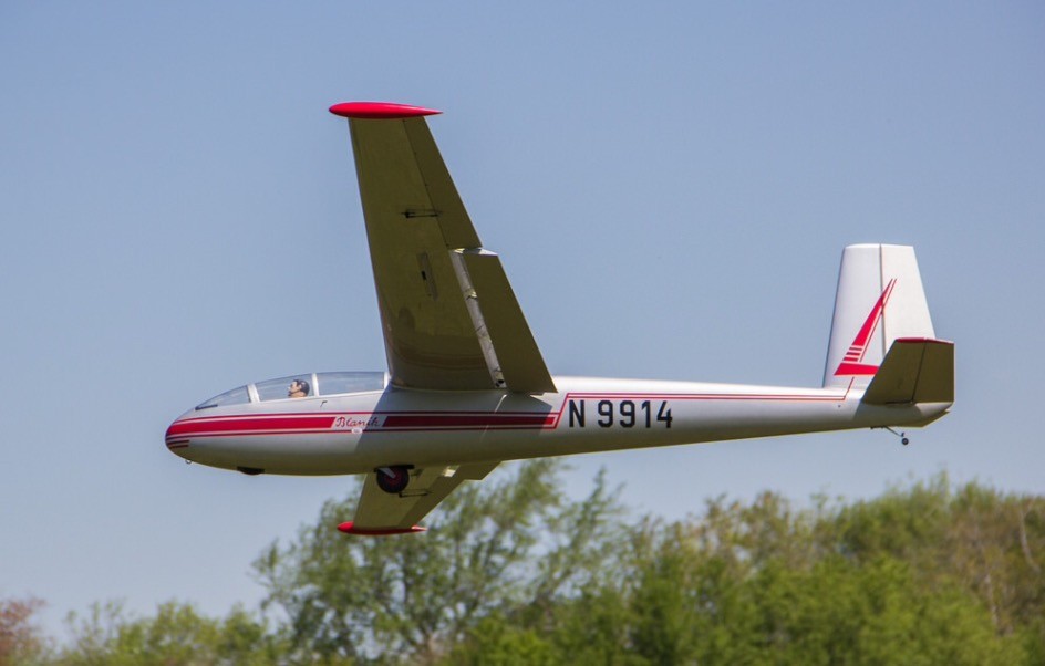

            Thanks to everyone for all the help...We had a awesome time in Muncy.
              Way to go Bob!
                Great news Bob!
