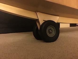

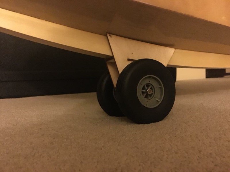

              Wheel size for the self launch dolly?
                4-1/2" DuBro Wheel
                  Jim just informed me that the fall away assembly is made up of 2 wheels!
