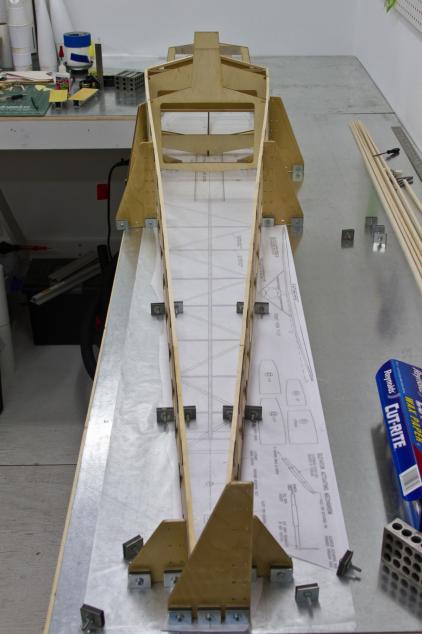

      As I noted earlier, the short kit Formers are 1/8" Ply, while the plans show them all as being built up with 1/64" Ply faces and 1/4" Square Spruce around their perimeter. As such, the Plywood Formers don't fit exactly as shown on the plan, so I have to make adjustments accordingly while still maintaining the proper dimensions to specific points such as wing strut fittings and wing pylon attachment points. Right now it's all loosely jigged on the bench and nothing is glued. I'll wait until my next week off to really tackle it. I go back to work tomorrow afternoon and I want to have 2-3 days off without interruption to ensure I can work slowly and methodically. I'm thinking I'll probably start with F5 and work fore and aft from there as that's the widest point of the Fuse.
      No Bananas Wanted! Looking good so far.

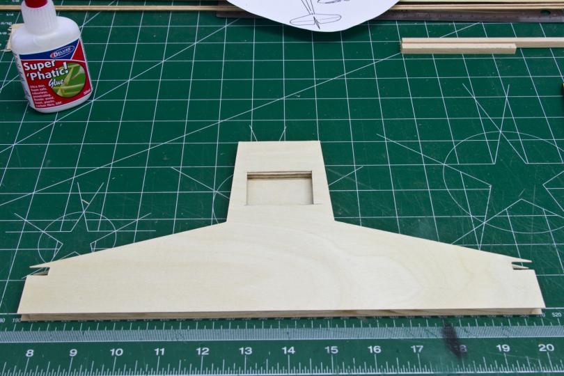

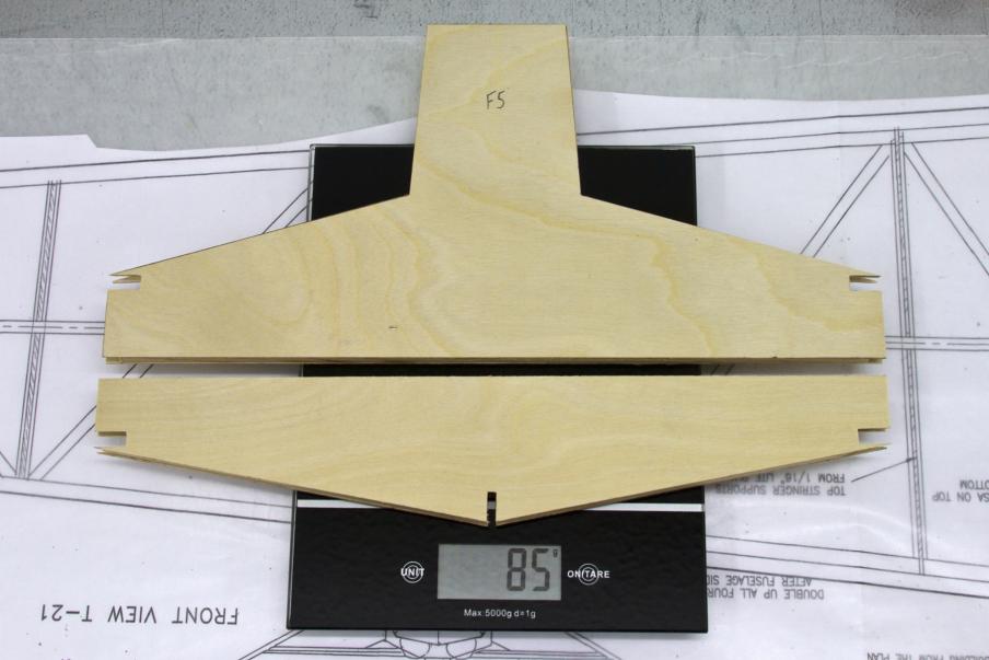

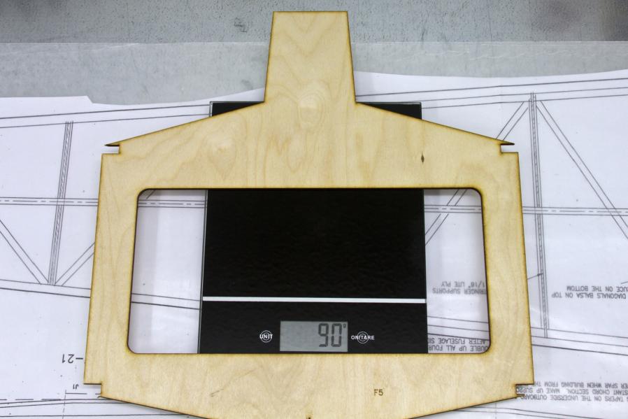

      After pondering the situation of the Plywood Formers provided in the short kit versus the built-up versions indicated on the plans and how things would come together, I finally decided to build up F5 and F6 also. It just makes fitment easier in the end I think, as the vertical 1/4" Spruce sides are already a part of the Fuselage sides. As luck would have it, they turned out lighter also!
      Do you ever get that feeling as your progressing along that something just isn't quite right? But at the moment, you just can't put your finger on it. Well, after taking a little break, I came back into the shop and looked closer at my plans and it jumped out at me. In my haste to make the new F5 and F6, I forgot to add some critical hardwood that the wing center section will get bolted to!
      Easy enough to fix though. Just cut out an opening large enough to insert a 1/4" Plywood plug in F5 and F6. The area of the opening will never be seen as it's interior to the wing pylon.

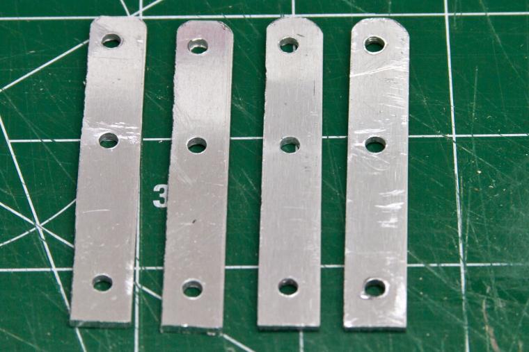

        I cut, drilled, filed, primed, and painted the wing strut attachment points that protrude from the Fuselage sides. They're simply cut from 1/16" Aluminum.
        I painted them first with an etching primer, then a grey paint. I'm wondering though if they might be 'too' soft?

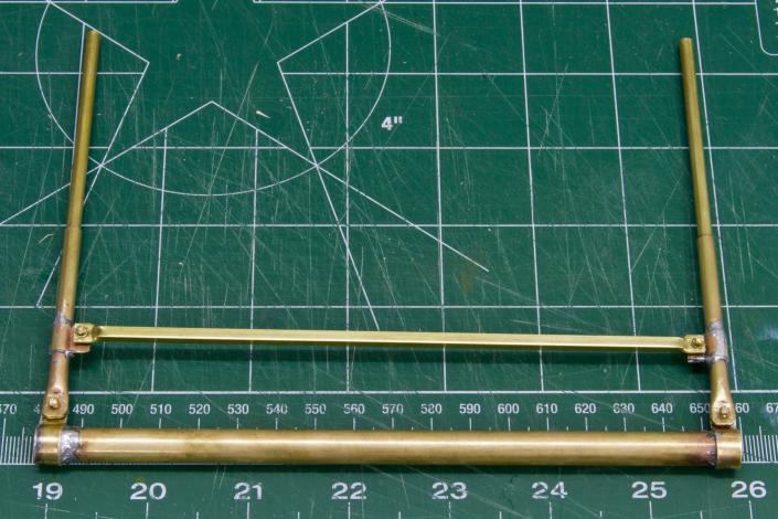

        And I did just a little more work on the Yokes/Sticks. This part takes a little more thought. I have the full size plans for it, but I think for the ease of making it all actuate with micro servos, I might use some artistic license in how I make and assemble it, but it will still look the part.

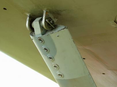

        Third scale, 1/16" soft aluminum? Maybe they should be from steel or G-10.
        otherwise nice job.
        • Tango Juliet
          Tango Juliet commented
          Yeah, I may have to revisit this step before it's all said and done. I've got some G10 I could use.
          TJ, I agree with Gunny, you can't make it to strong!
          TJ, how were the full scale fittings made? That's a good place to start. I like my old standard 'heat music wire hammer flat then drill and tap' fittings!
        Michael, here are photos of the 1:1 strut attachment points.

        And the wing attachment points...
Name:	Wing Struts (4).JPG
        I have some G10 material that I can use, but I thought I would improve the design just a bit more, borrowing slightly from your one-piece music wire method. I placed an order for more G10 that was long enough for me to run two continuous pieces from one side of the fuse to the other (13 1/8"), rather than four separate pieces for the left and right side, as the plan shows. They'll be bolted to the F5 Former front and rear, and that provides the gap between the tangs (which is also why the built up formers work better than the 1/8" Plywood formers in this instance).

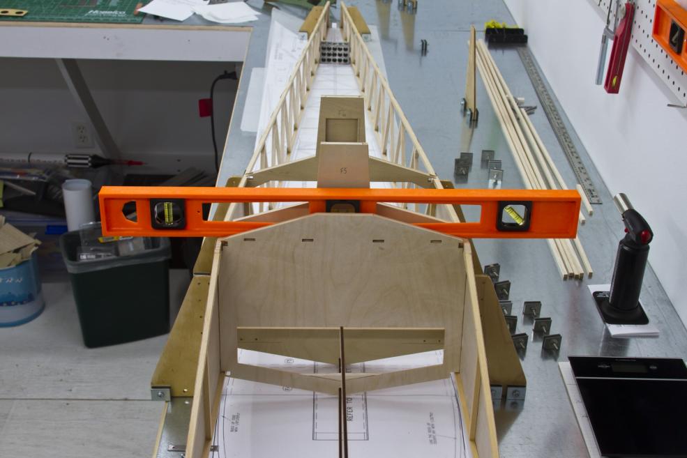

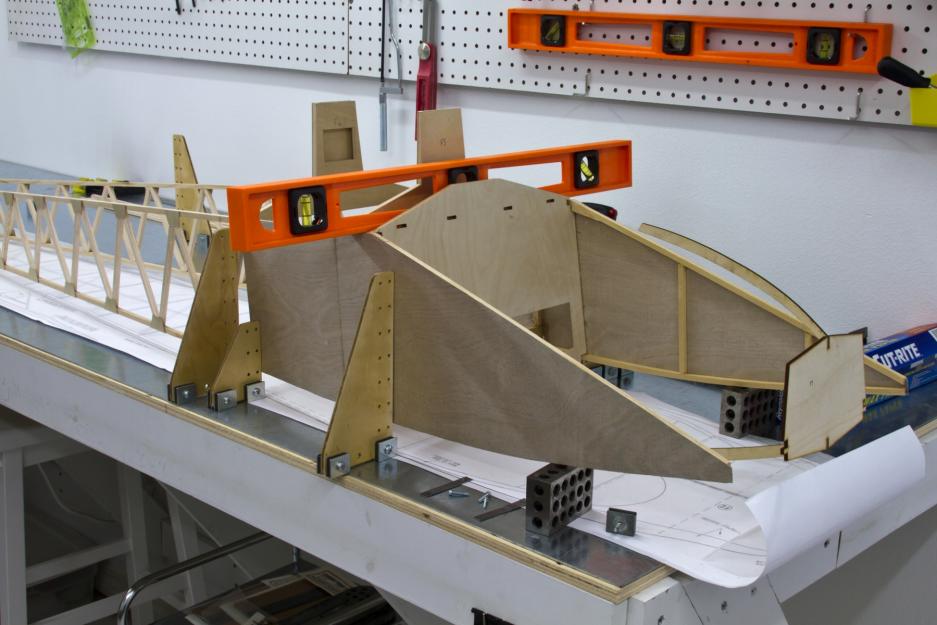

              Another week off has just about passed. And again, not a lot to show for it. But, that's life sometimes. Here's a few images of what I did manage to work on.
              I was able to get F4, F5, and F6 into place and glued. Laying the level across the top edge of the fuse sides helped to ensure that everything was remaining true.

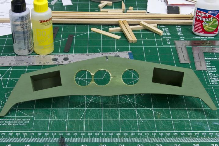

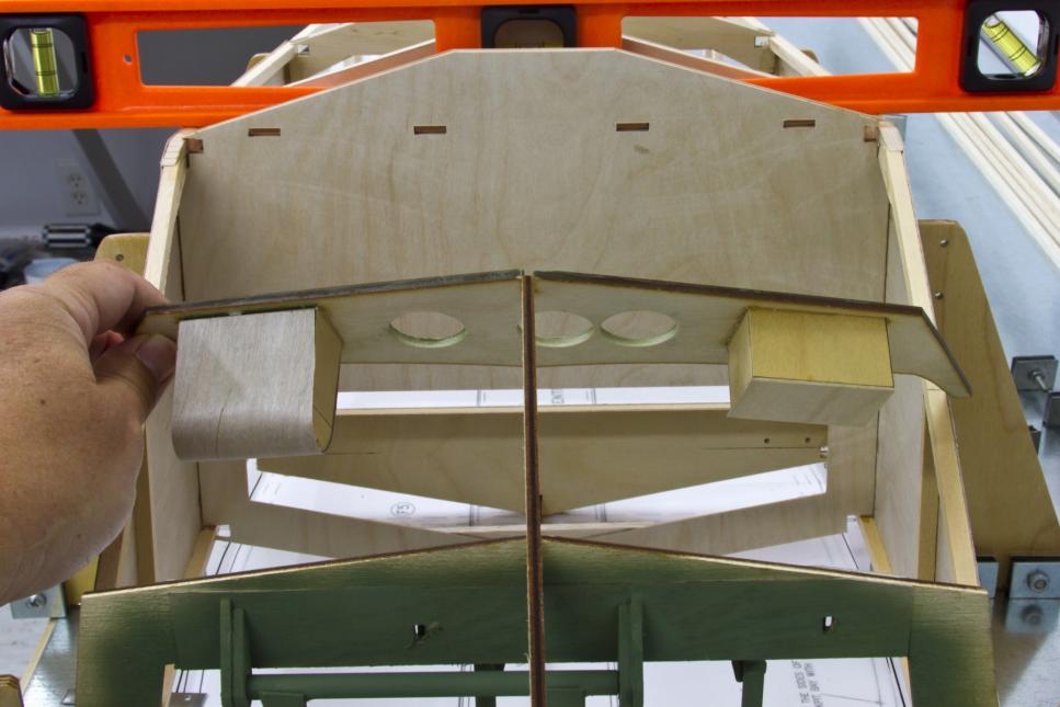

              I was able to finish the assembly of F2 with the Rudder Pedals and get those painted. Here is F2 in situ, but not yet glued into place. You can barely see F1 in front of it, being suspended by the upper and lower keel beams (which are also NOT glued into place yet).

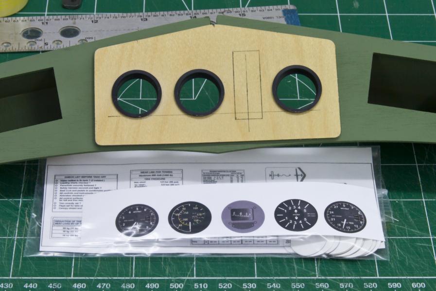

ID:	20560As it sits in the above photo, the fuselage sides are too narrow to fit the F3 Instrument Panel, and oddly, there is no Lower F3 on the plan that would define the forward portion of the seats. When the portions of the fuse sides forward of F2 get pulled in toward F1, the sides bow outward between F2 and F4, then F3 fits as advertised.
ID:	20561F3 got paint also, as well as opened up to accommodate dial instruments from IFlyTailies. I'll have to hand-craft the vario. Then the Instrument Panel will get black paint before adding the instrument faces.

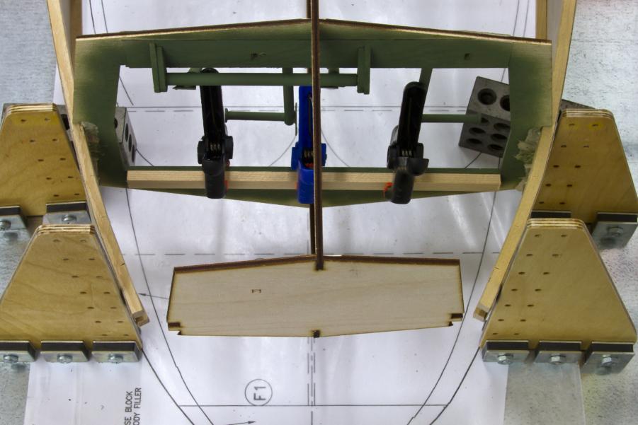

              I got a little stumped this week. Where I need to pull the Fuselage sides in at the front to capture F1, the curve gets pretty tight and it seems that the sides are coming up a bit short of where they should be. It seems maybe that the plans didn't quite account for the curve eating up some of the length. The camera angle makes it look even worse than it is, but F1 is about 1/2" aft of where it should be, and if I squeeze the sides in to where they would meet F1, then it still needs to come back another 1/4-3/8".
              What I'm considering is cutting a new, enlarged slightly, F1. Or... Pull the sides in to the current F1, then scab on more sheeting to the outside to get to the correct scale outline. Scabbing on more balsa sheeting wouldn't really be a bad idea I don't think either since I'll surely need to add nose weight for CG anyhow. It wouldn't look pretty, but unlike ARUP's sailplanes, this one doesn't have exposed plywood sheeting. It all gets covered with fabric (Solartex in this case).
              Input from the masses is quite welcome here.

                I guess F2 is just in front of those 1-2-3 blocks? If so laminate 1/16 bass or ply strips on the inside of those longerons starting at F2 to reach forward to F1 or however long they need to be. Laminate them while maintaining that curve and even consider putting CF tow between laminates. When cured adjust the notches in F1 to fit the added thickness. Add some gussets strategically to maintain 'trueness' of the shape. Add filler balsa strips to the outside of the longerons then sand fair. Violin! done! That's how I see it being done from my arm chair.
              • Tango Juliet
                Yes, that's F2 in front of the 1-2-3 blocks (the clamps are holding a piece of hardwood against it to keep it from bowing while I pulled the fuse sides in). Your idea is another alternative I had not considered. For now, my thinking is to just cut a new, larger F1. Then I'd only have to make the nose block larger, deeper. And the nose block is the perfect place to add needed weight. All of the interior from F3 to F1 gets fiberglassed (and probably some carbon veil as well) to really make it all rigid.
