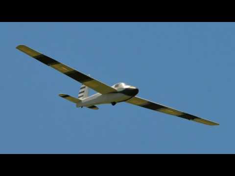

            So here is the prototype in flight.
              Congratulations! Those are some tight tow turns. ;-)
              I put your video in viewer mode.
            Nice, although it's funny how the SWISS CROSS on the Cub is obscured in every picture by the glider wing......does it need inspecting
              Ya, maybe.

                Tight turns, a recurring problem. Cause...gusting wind or more likely pilot skills.
