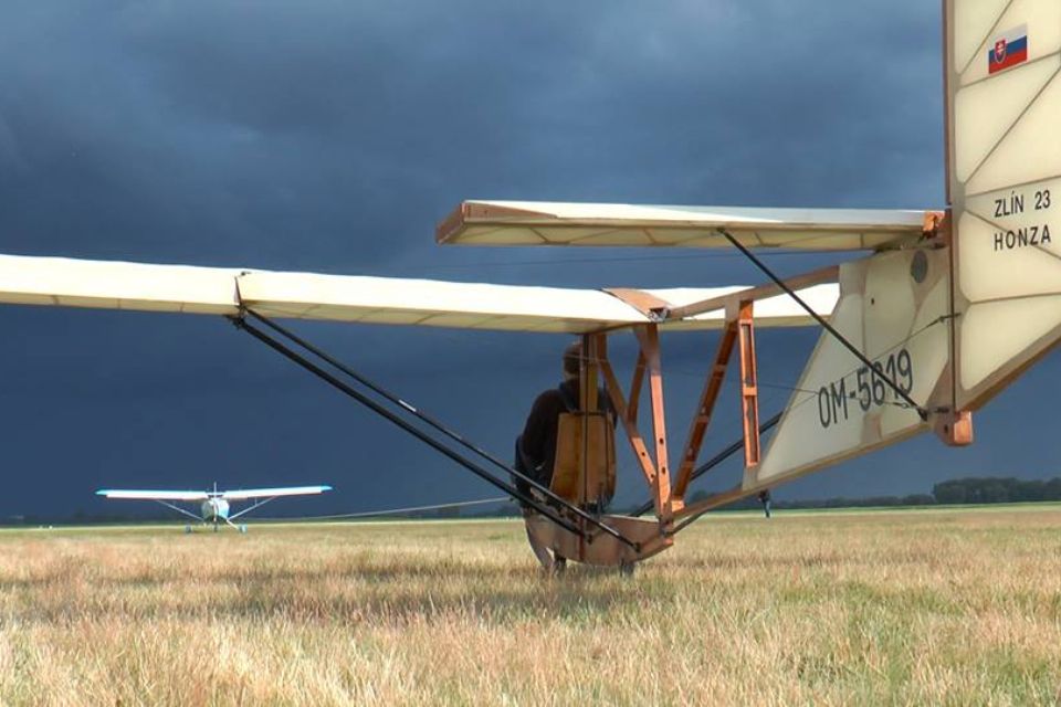

ID:	11451 My 2 cents worth....
                        1) Please use the Krick plans and scale them up to 1/3 scale. 100% better details and info needed to complete your model.
                        2) Thin the airfoil out!!! The wing loading on these planes are so low you need a RC glider type foil. old school 7037 would be good. Yes it is not as scale but it will make you smile more if it goes up in a thermal.
                        3) Do you have your heart set on a SG-38 with wires. The full scale boys and myself learned that it takes a long time to set up all the wires. At some point they removed the wires and replaced them with struts.

                          Hi Erich.
                          Thanks for the info.
                          Struts are a good idea. I know all about wires as I flew a 40% Waco (moki 400) for a number of years.
