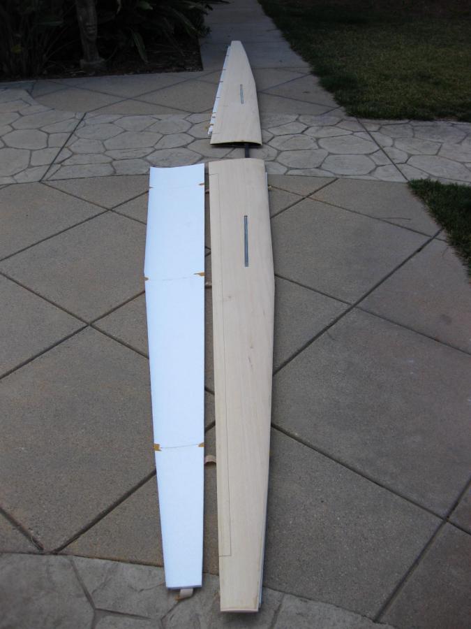

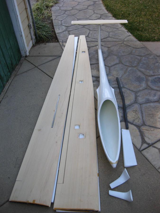

    What to do with a Rosenthal DG 600 fuselage that I acquired a while ago ....... build a thinner airfoil wing and see how many laps it will do.....
    To speed the project along, I talked with Bruce DeVisser ( Rosenthal-Flugmodell-USA ) to see if they might be willing to build a custom wing.....and they said... Yes....
    Using some specification from the Antares, Arcus and AN-66....we came up with a plan.

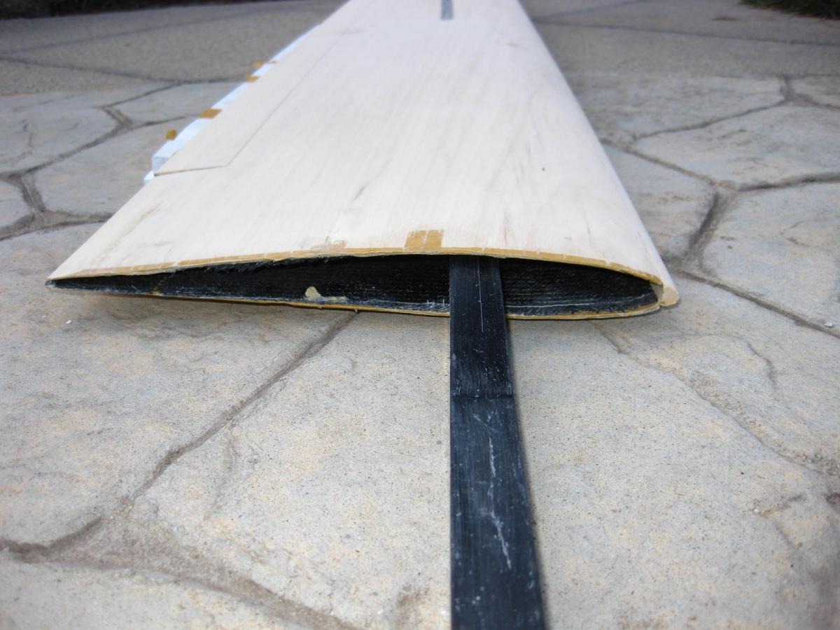

    Even better is that Rosenthal has a new 25mm square carbon wing jointer that would be perfect for the thinner airfoil.
    And now the wings are in hand...also a horizontal stabilizer and rudder too.

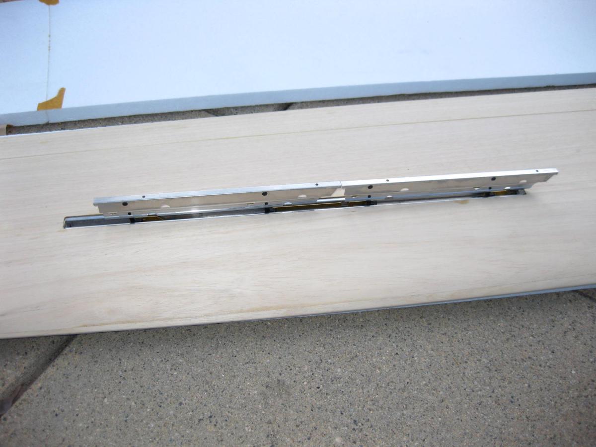

    Wing has a overhang so I can blend it with the fuselage's original HQ 3/15 airfoil. .......500mm spoilers

        That fuselage looks familiar.... Which set of airfoils did you end up using, Scott?
          Hi Mike,
          I thought you might recognize it.....The Airfoil is as you recommended....HN-354HR 8% thickness at the root (33mm) and 1.6% camber. Thanks for the help.

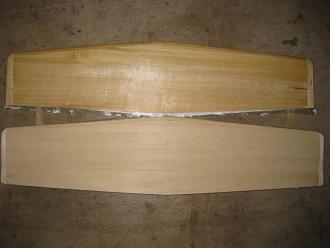

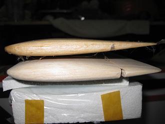

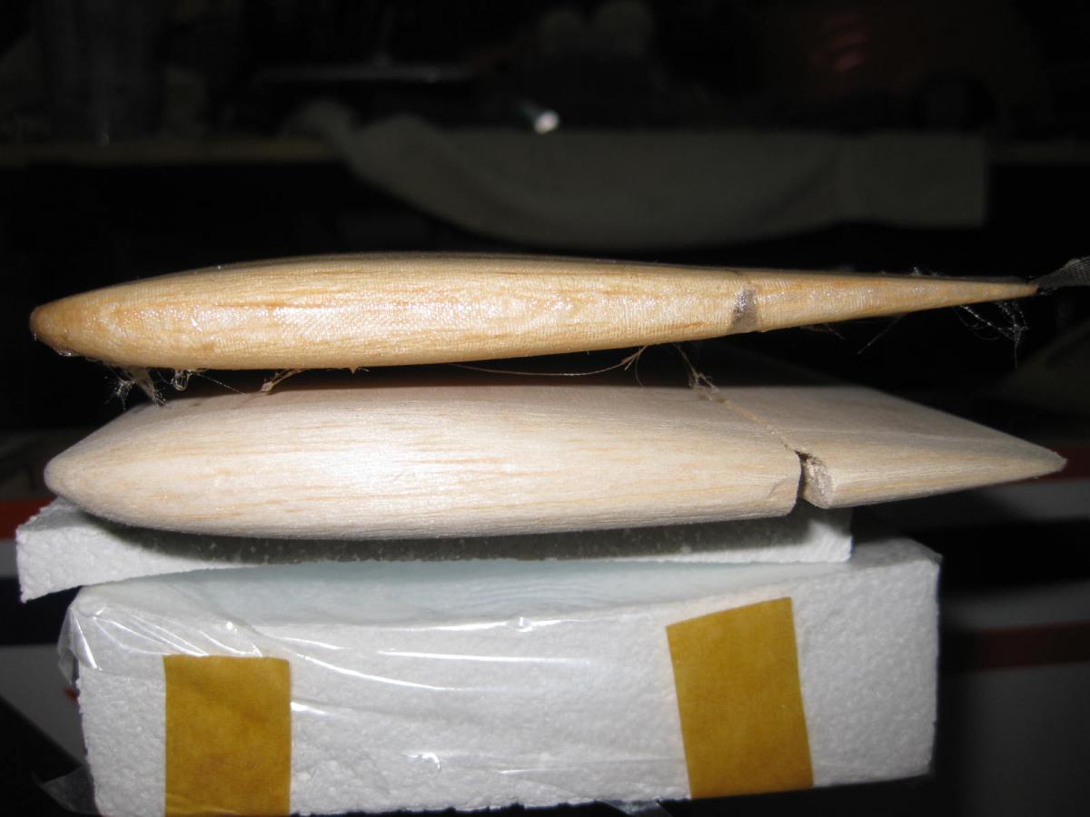

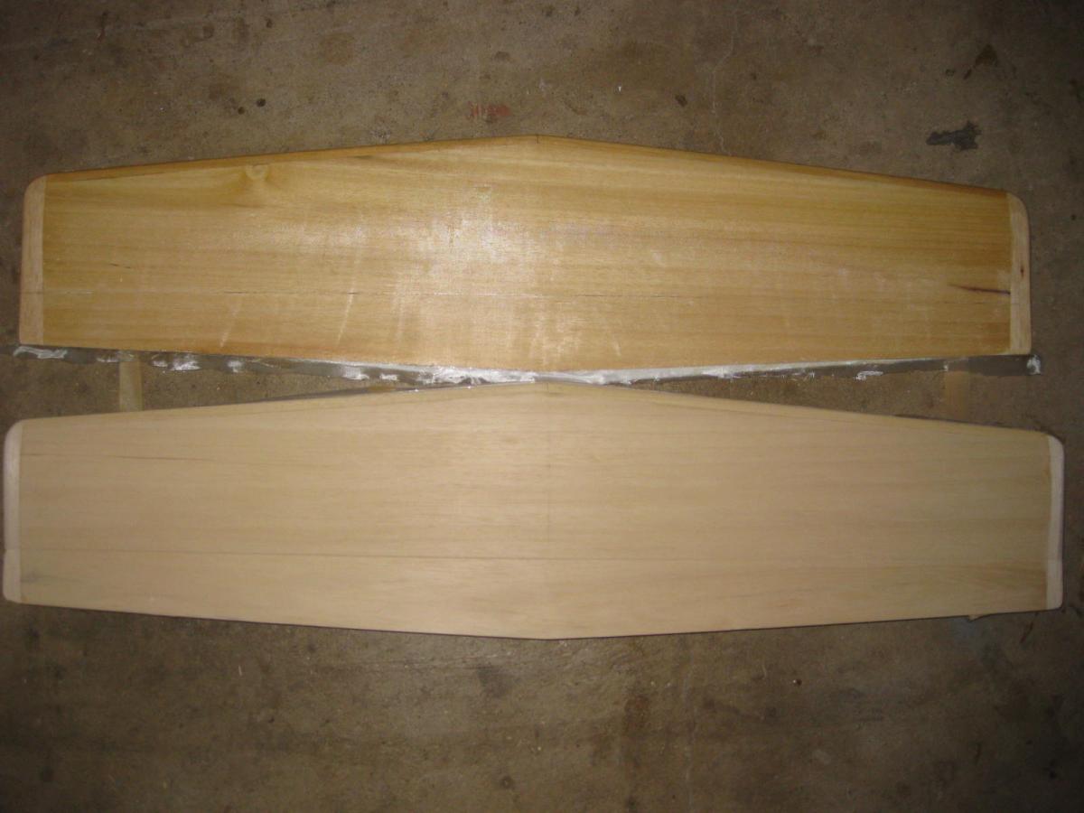

          Rosenthal also did a thinned airfoil for the stabilizer -
ID:	8131 Click image for larger version
          As you can see I've started in on the thinned stabilizer with 0.73 oz fiberglass and West Systems Epoxy.
