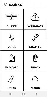

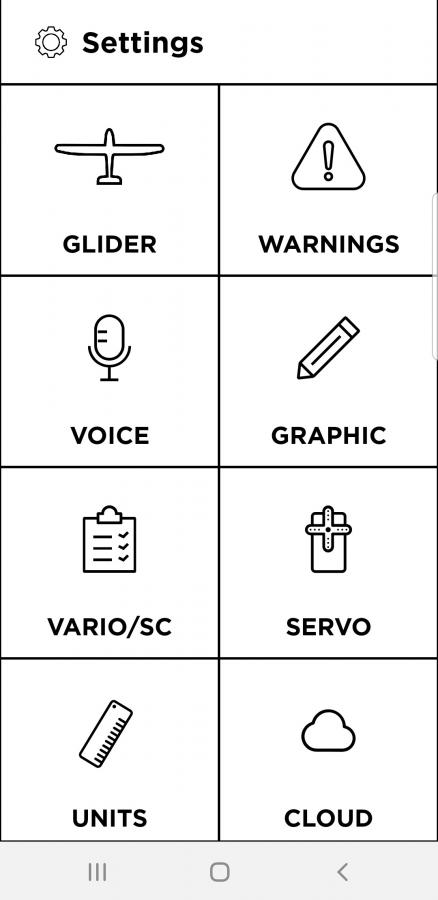

      Sometimes in Albatross there are some kind of hidden settings and options. One I found was for beeps.
      If you go to the settings screen. You see a page full of things.

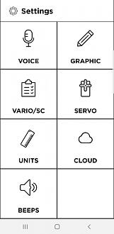

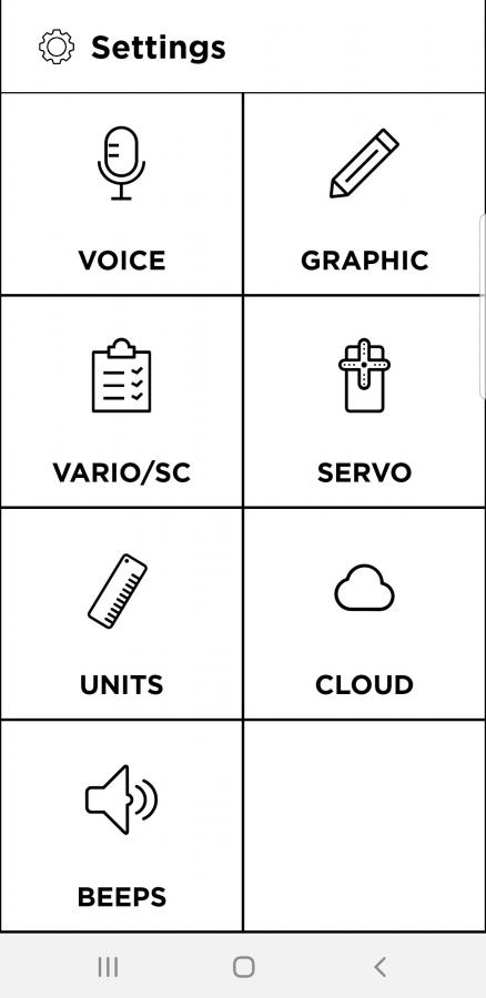

      Well, there are some more that are there but it is not obvious. If you scroll the screen up you will find Beeps.

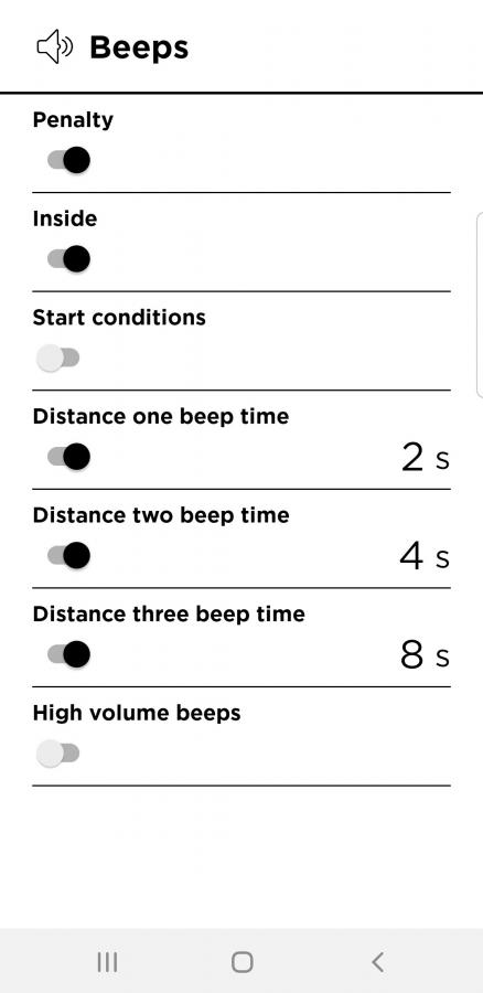

      And if you click on Beeps you get.
      I see one in there I want to try. High Volume Beeps. I think this might help on the distance to time beep and turn beep.

          High volume beeps are definitely useful. That's why they were added.
          Rick Shelby
          Team Horizon
            thanks Rick for the breakdown...so the various 3 beeps for the turns, do they only have that switch for high volume? or does one of the snipe blue and green volumes also adjust it to a degree?
              Mike was correct earlier when he said the green led indicates that the buttons are adjusting the vario beeps. That also includes the turn beeps. When the blue led is lit (by pressing the Mode button) the buttons adjust the voice volume. If "Hi volume beeps" is selected the turn beeps are 20% louder than the vario sound. There is no way to adjust how much louder they are. Each user needs to find a happy medium between the volume of the beeps and the volume of the voice. Murphy's law states that there will be beeps when you are trying to hear the voice and there will be a voice announcement when you are concentrating on the beeps.
