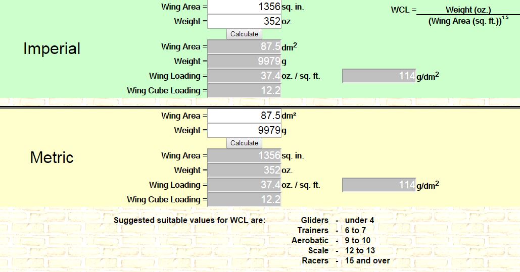

                  I have a "smaller" 5 meter ASW 28. It's loaded down with 2 x 4000 mah 4s batteries and other gear for a nose mounted SLS system and feels quite heavy in the hand. I think pulling the system out could save me 2-5 lbs. However, I want it to fly like it's full scale counterpart and worry that the lighter wing loading won't help.
                  Two questions:
                  1. If we want less inertia to roll and pitch it seems like the best place for weight is at the CG point inside the fuselage right? I've also read to put the weight in the wings. Heavy wings are like heavy lever arms and it seems would be akin to a tight rope walker with a pole. So why do we want the weight in the wings, it seems counter intuitive.
                  2. I have seen some "formulas" for determining ideal wing loading for a glider, slow flyer, acrobatic plane, etc.
                  Using this formuls my 1:4 DG 100 is a brick with 3x the recommended wing loading for a glider. On paper it would not soar. However, it soars and climbs remarkably well. The weight seems to help. What guidelines do people use to figure out how much their sailplane should weigh? What characteristics are most apparent when a sailplane is too heavy? Too light?

                    Another factor is the airfoil. Some airfoils perform better at higher speeds. The best L/D and minimum sink and all that stuff. The heavier the sailplane the faster it flies. This improves performance with some airfoils. Back in the day we found that the Lawicki Duck flew better ballasted even in light lift.
