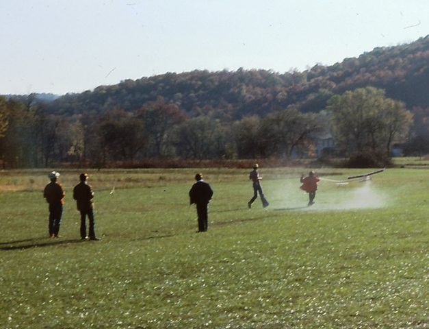

                      My experience with aerotowing goes way back to 1976 and it started with polyhedral RES sailplanes typical of the time. We used wing tip runners to keep the wings level until both tow plane and sailplane were moving. By doing this, we mostly avoided disasters at the beginning of a tow. Once in the air, the sailplane pilot had to resist using any more than the slightest control input or it would start a "Dutch Roll" event that would quickly go very bad. The sailplane needed to have a servo driven release and the sailplane pilot had to be quick on the trigger if the slightest issue occurred.
                      Mostly turning was out of the question. What altitude you could get going straight ahead was it. That didn't stop us from trying to turn, and occasionally we could get through a 180 degree turn. Usually, the sailplane would need to release mid-turn with things going bad fast.
                      Even though I was game to do it, having the only tow plane available, most sailplane pilots found high start launching much safer and less nerve wracking. Also, most did not want to install a tow release requiring an extra servo.
                      Here is one of our launches (circa 1976), I am the tow pilot second from the left. You can see the two wing tip runners down the field and both the sailplane and tow plane just getting airborne.
                      Click image for larger version  Name:	ATHighRes.jpg Views:	1 Size:	64.0 KB ID:	31491
                        What a great picture! It is a perfect example how friends interact within the aerotowing community!
