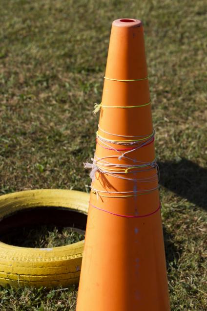

                    In this photo of loops on a standard traffic cone, you can see the various size loops and thickness of cords used depending on the size/weight of the sailplane being towed. For some it's also a personal choice. Some want a stronger loop, while others want it weaker.
