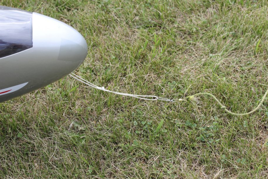

    Ok guys,
    So I was at Cumberland and of course I forgot the tow loops that I had made up for the trip so I'm thinking "what do I do now?"
    Len came to the rescue and produced one from his pocket, so all was good in the universe for the first flight.
    He told me to take the previous tow-ees loop off and put it in my pocket to use later.
    So just what is the proper tow loop etiquette at an aerotow event like Cumberland?
    I did see Jim putting some of the loops onto the flight line pole he had there.
    Is that where you get the loops from for your next flight?
    Do I make a bunch to keep in my pocket?
    This is just one of those things that doesn't get mentioned too much....
    Regards,
    Blake
