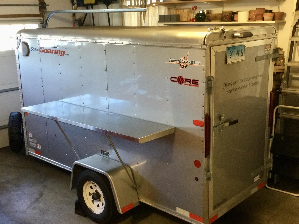

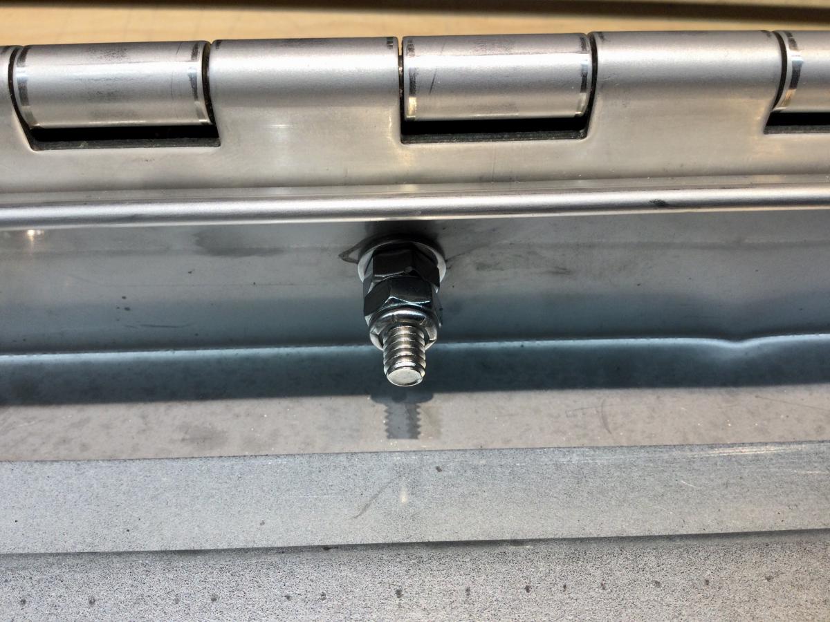

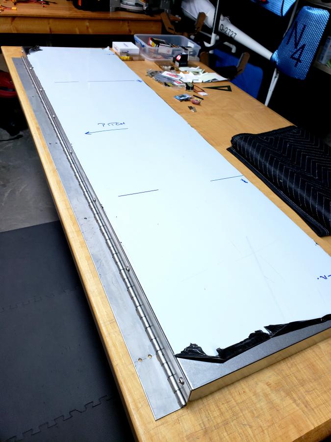

Here we have the resulting project. I purchased a 304 stainless steel 6‘ x 18“ table from a commercial restaurant supply house. I also sourced a 6 foot long by 4 inch wide 0.090 stainless steel piano hinge (free shipping!) from New Hampshire Hinge. Lots of stainless bolts, nuts, washers and screws from Lowe’s — the 25 quarter inch holes I had to drill into the combined hinge and table were quite a process. Slow and steady wins that race so as to not work harden the steel.

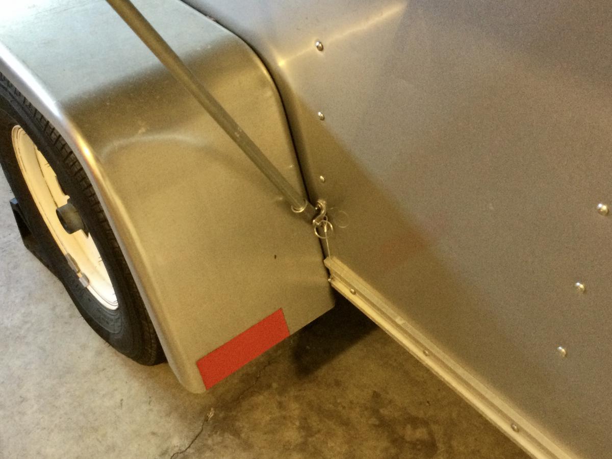

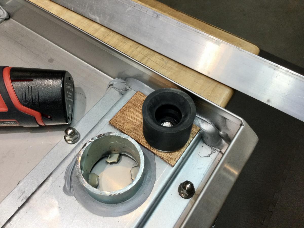

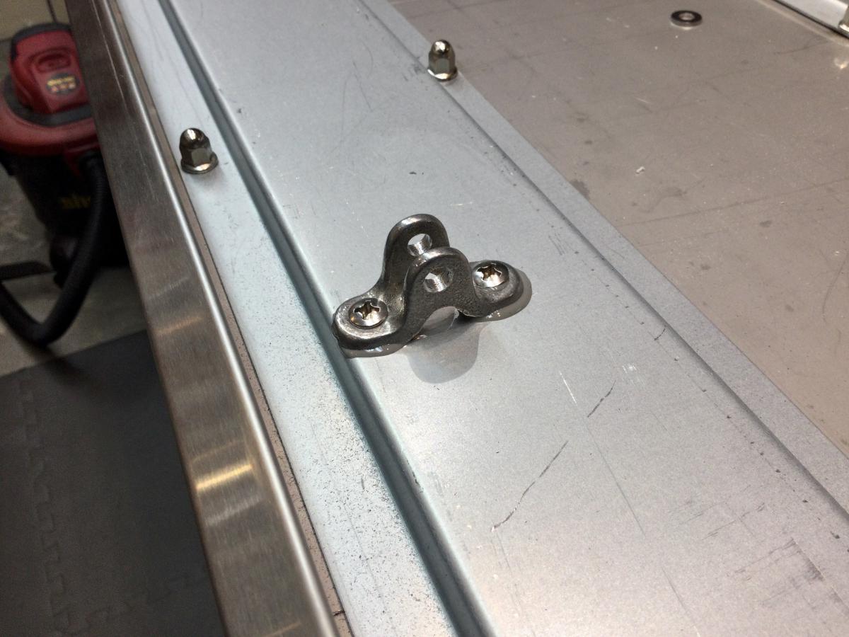

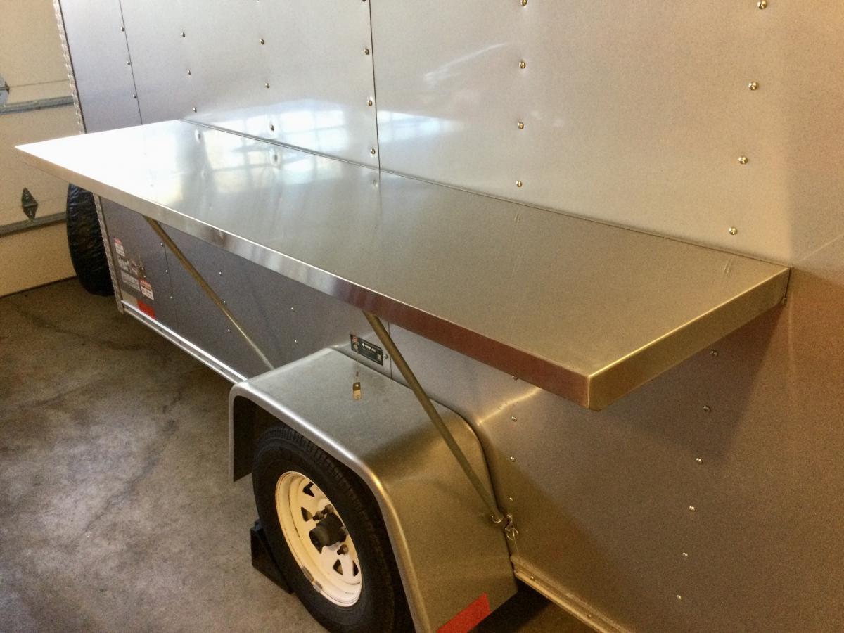

The leg mounts for the table were cut off with a sawsall and heavy rubber bumpers (EBay) were added to cushion the table against the trailer when folded down. Aluminum electrical conduit legs were fabricated and attach with camelback hinges that have added Hysol EP90FL at their base and fix in place with lock pins. Yamaha snowmobile shroud straps secure the table when folded.
