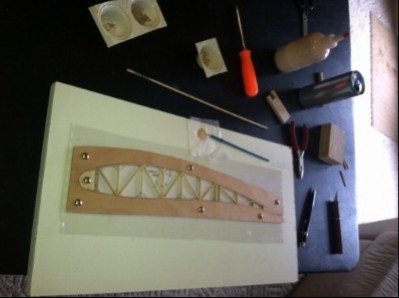

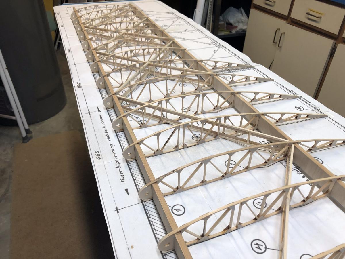

And here we are now. My big progress this week has been getting the ribs glued to the spars - which sounds easier than it is with something like this. The diagonals aren’t even glued in yet and this wing is already very stiff. I had to add small spacers under the rear spar openings to fill the gaps (similar to the fulls scale), but everything is snug and tight.

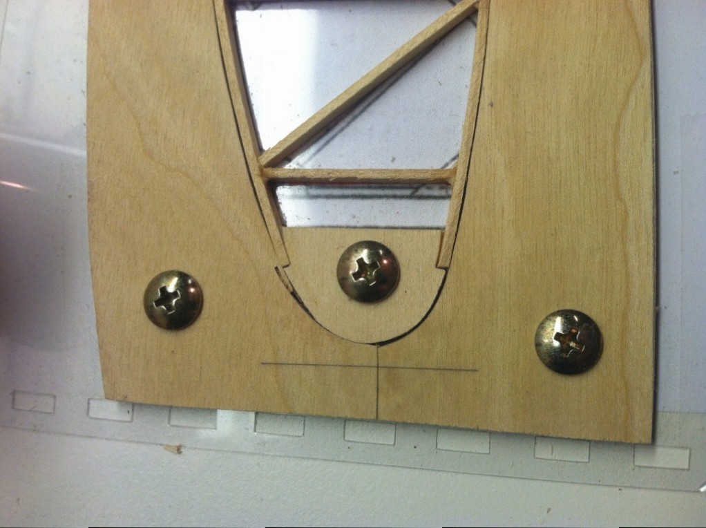

Ok, this isn’t all that exciting but also one of those things that I’ve been thinking about for a while. The leading edge of this wing is wrapped in ply, but it still has a small stringer that goes along the ribs behind the ply. So I made a pattern out of flashing aluminum that fit the spar and each rib nose with a small slot cut that matched the stringer width and depth. Then I marked it with a pen. When all were marked I made sure they lined up and started cutting with the dremel tool - very carefully. Lucky me, they all lines up very nicely and now I have a a nice straight basswood leading edge. By the way, that’s the framed up port side wing so now both wings are framed and glued.

I managed to get most of the trailing edge on both wings installed by slotting each rib to accept a 1/16" ply strip which is then capped by a 1/8" square basswood trailing edge. It will need some slight shaping, but it turned out nice and straight and very stiff. And exactly like the instruction manual from 1935 says how to build it.
One of my deviations from stock was with the root rips. These will be capped with a ply strip and "out of sight", so I beefed them up a little and made each one out of 1/8" bass. They really don't take any kind of load like a typical root rib because of the wing attachment configuration, so I thought I'd try something simpler than build 4 more ribs from all of the little fiddly bits.
