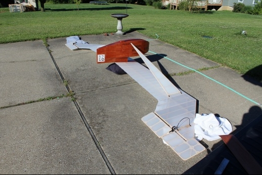

      I made another lead slug for balancing purposes. Weather permitting it will get assembled so the exact amount of lead can be determined to balance at 20-25% MAC. The center section gap cover is completed. It has a tongue and groove receiver at the front and the rear end is captured by a magnet. Cockpit coaming has been sourced from an old leather tie. I was a hipster dufus punk rock kind of guy in my younger days so I'm glad I saved the tie! So far, only six bolts with nuts are required to assemble the Charlotte! Pics to come!
      • Michael-model looks great! Looking forward to seeing it. Bill
        • Thanks Bill! I hope it flies. I assembled it this morning for some beauty pictures and balancing. Looks like the Charlotte is gonna be just shy of 18lbs if balanced between the 20 and 25% MAC mark. I have to make a form into which to pour molten lead that duplicates the interior nose space so the lead slugs can be bolted in place. Assembly is pretty easy: put wing rods into one wing, inverted just slip fuse onto rods, add the strut (3 bolts), slip other wing in place, add strut, invert to add two wing hold together springs, connect servos to links and, lastly, add wing gap cover.

                      I made a form to pour lead. The slug has cooled off. Now I need to retrofit a nice secure box to place the slug. I really need to remember to do this before closing the fuselage up for these things usually need nose weight! I still have about 30% more lead to place around the nose area. I plan to make it more or less easily removable/ adjustable.
