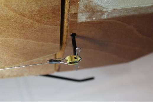

Mehr... The skid was attached to the fuselage. The guide tube for the nut driver tool works flawlessly! Proctor Enterprises brass fittings were modified to make the connection from the pull-pull cables to the rudder horns. A split pin facilitates removal of the rudder from the fin. Beauty shots follow. The venturi is getting fabricated. Seat belts are needed. Gap covers for the wings are needed. Cockpit coaming is needed. A storage box is needed. Flying will commence after receiver installed.

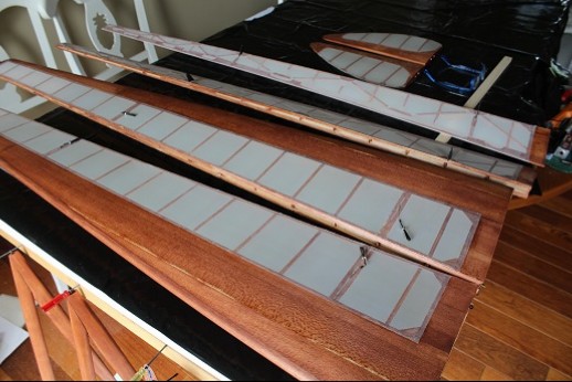

Hallo! Here are some pics of structures with semi-gloss polyurethane varnish applied with a brush. Tweezers were kept handy to remove debris and loose brush hairs. The color change is very noticeable after varnish applied. Beauty! When these dry the other sides can get done then a second coat will get put in place.

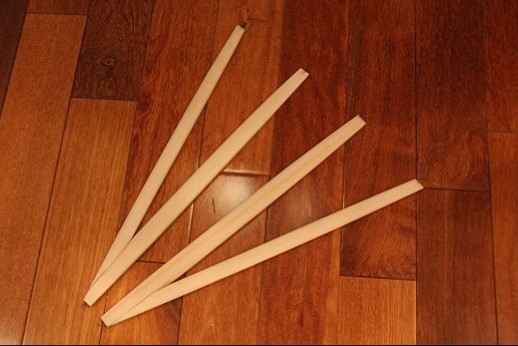

The main struts were joined up with the aft struts in situ after much trial and error sanding. The first pic shows the start of the process... marking, sanding, sanding then sanding more and more... Once the epoxy cured they were removed for finish sanding and staining. A picture of the stain used is shown. It gets thinned 50% with water and being a water based stain doesn't affect glue joints. I stain joints before gluing so that after sanding the joint the wood isn't 'white' where the glue has been absorbed. Everything will get polyurethane varnish tomorrow. This bird is almost done! Some detail items like a venturi and cockpit coaming are needed then the rudder cables can get set up. Whoopee!
